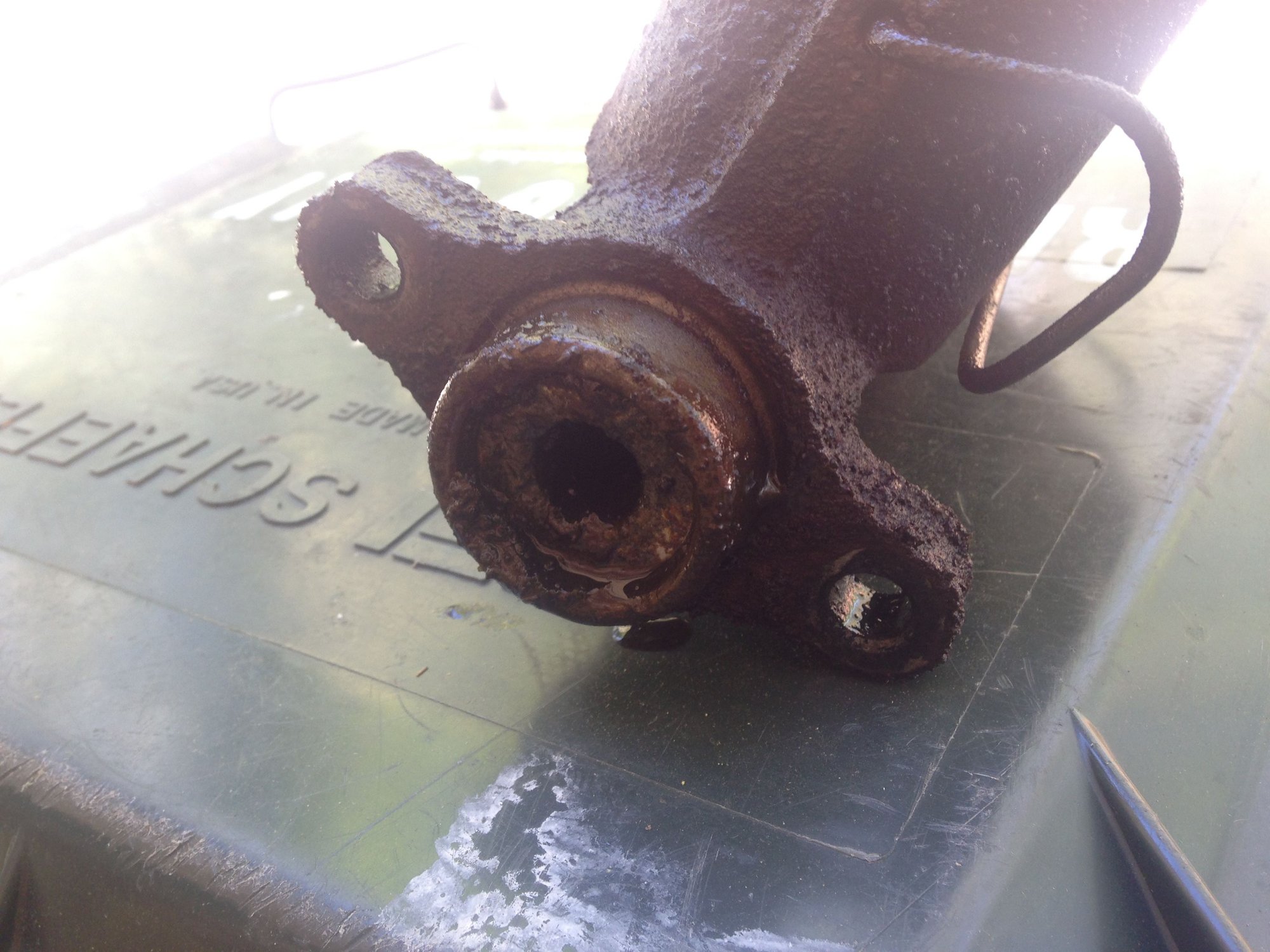

so i just went outside and heres what happened:
1, i topped off both chambers of the reservoir, and pumped the pedal numerous times, the pedal felt sturdy and hard to push down (came back a bit slowly though, but im guessing because its a bit sticky from sitting so long)
2 i checked the reservoir afterward, and the larger chamber was still topped off, and the front one was half empty.
3 i filled the front chamber again, and pumped the pedal again
4 the front chamber was half empty again.
Do you think that maybe the lines were just so dry that they still need fluid and its being sucked down into the lines, or do you tihnk its actually leaking? the pedal feels pretty good, and it definately feels like theres resistance, but with the front chamber being half empty im pretty dubious. thanks

Before you tear anything down, fill it up with brake fluid and find the leak. My master cylinder was leaking where the booster meets the back of the MC.

Right when I post a reply , Check for fluid coming from or under your rear wheel cylinders, and the block on your rear axle.
