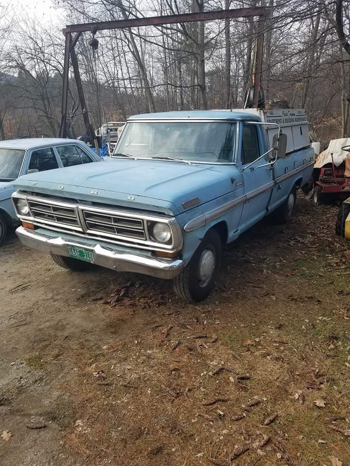

heres a recent photo
thanks for the reply i posted on here cause i couldn't find out where the jack was located along with other things but don't know them yet

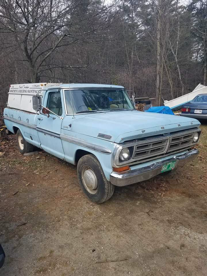

Welcome. That's a nice ranger trimmed 250 with a bed tool box. One thing though, I was looking at the hood and the 250 ornaments look like 67 only ones but the picture could be fooling me.

Good eye, they do appear to be 67 emblems, which would probably mean a hood replaced. 67 will not have the front edge trim and fount size on the script is smaller. Now we look closer for other collision damage in the front.

The hood emblem IS 67 and im pretty dawg gawn sure you never saw them on a 68.
the side trim is of the 70-72 era.

this is a picture of the hinge and it looks like the hood matches but the badges were changed

1968/72 hood side emblems have yellow reflector lenses, 1967's do not.
