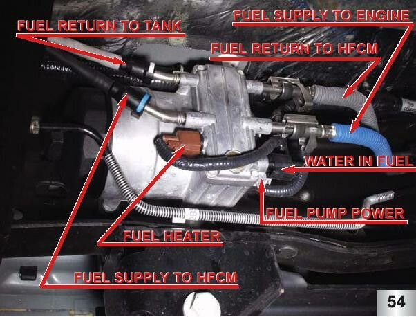

How and when are you seeing air in the secondary bowl?
Do you see air bubbles when cranking OR only when the key is first turned on NOT cranking?
If it's getting bubbles with key on not cranking then the pump is drawing air. Check the HFCM water drain to start. If it's not sealed it can draw in air and it will show in the upper fuel bowl. Also if the line from the tank is leaking it can draw in air. You can disconnect the lines and put in series a piece of clear vynl tubing before and after the pump to see when the air is being introduced, before the HFCM pump or after.
If it's getting bubbles while cranking (no pump) then you may have a bad injector body o-ring or bad injector pintle.
