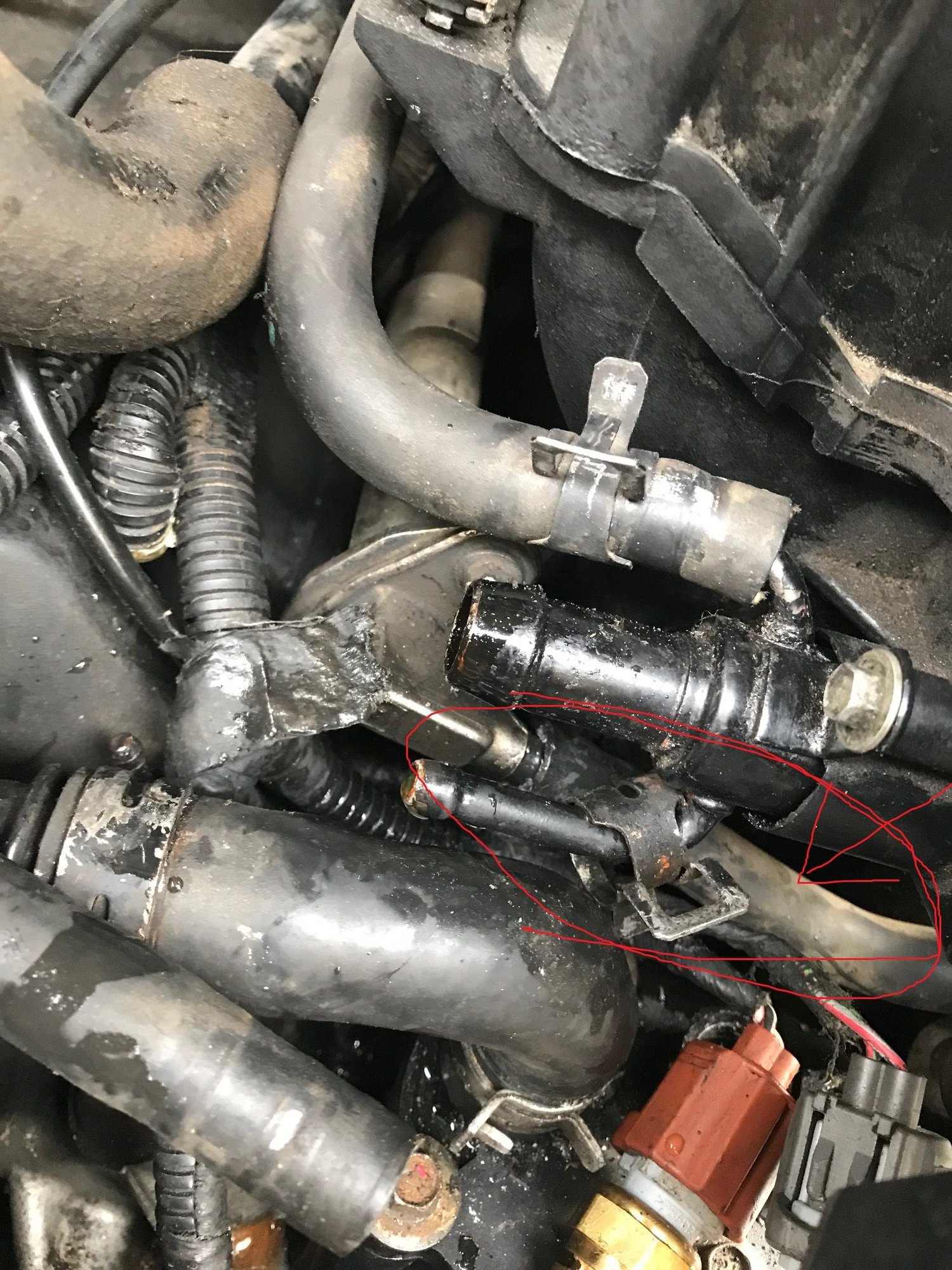

The connection hose between the two fuel rails is leaking badly - I think it is a solid metal pipe with a hose covering it. I need to replace it.

The close photos are great, but an overall photo would help to orient the observer to the engine compartment. I can't tell if I'm looking at the top, bottom, left, or right side of the engine...

It is the front of the engine and it is the tube that connects the two fuel rails. The tube runs under the intake and behind the thermostat housing.

Yes that is the part!!!

Try entering your vehicle VIN # here Official Ford Parts Site | Buy Motorcraft & OEM Ford Parts Online | FordParts.com & have a look in the Fuel system, fuel injection illustrations breakdown for the part & part number. If you click on the illustration in the left side bar, it'll open a magnified image of parts with their part # & location.
