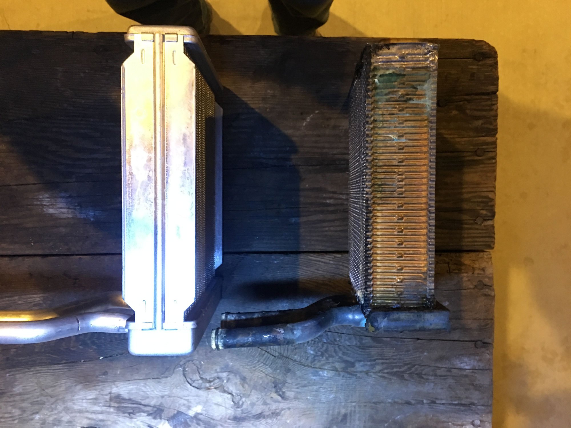

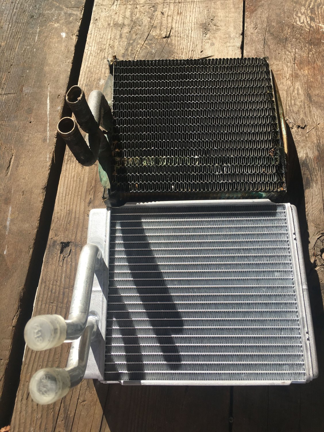

This windows on my 1985 F150 5.0 A/C started to fog when the HVAC was turned to hot.
The old core was beginning to leak but the issue I have is the replacement will fit heater core from Autozone looks similar but doesn’t fit. Has anyone else run into this? What was the resolution?

What does "not fit" mean? How does it not fit?
Why was the numbers marked on the box the way it is? Was the box opened before you got it?
Only other one I see listed is this one.
https://www.autozone.com/cooling-hea..._406242_0_5281
You cant always go by pictures but this one may work.
Oh I had 84 saved so that is why it said 1984 truck but I cant see a year making that much of a difference.

The cores appear to be very similar except for the top tank,
the OE is offset and the replacement isn’t and that portion of the tank is keeping the core from going into place.

I exchanged the core for another with the same part number; this core tank had rounded corners and fit into place.
