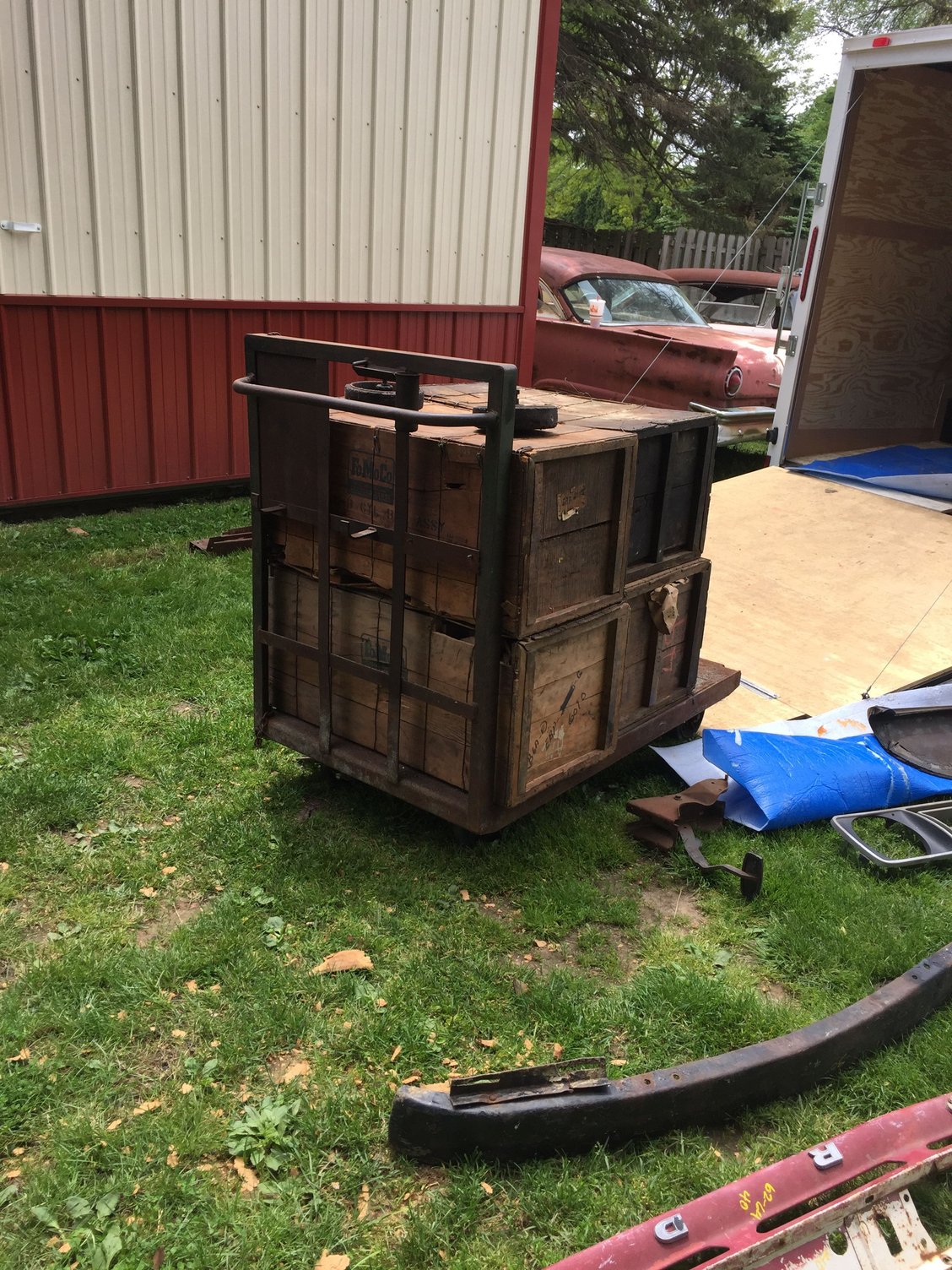

Seems to me you’d do well to start lining up a replacement 215, just in case yours can’t be saved. Or at least a donor engine to combine with parts of your own that can be saved. Several of us probably have extras. I know that a member there near you in OH bought a NOS block a while back and may still have it available. I have what’s left of a long block engine that I’ve picked parts from if it’d be helpful. It’s a long block with all internals intact. I’ve not had it apart so don’t know the condition of its guts. Stu
that would be me. I still have one

I have a block from what was a running 215 over here in central PA that I know is good. It measures to stock bore but one cylinder is scored from a broken ring. Should be easily machined or sleeved. I have other miscl parts but you might have everything else. I sold the head but yours is probably good. FREE, come get it!

Yes, Kevin, that would be you. I didn’t recall you having four! And I’ll mention it before a moderator comments, there is to be no talk of money in the threads. Stu
