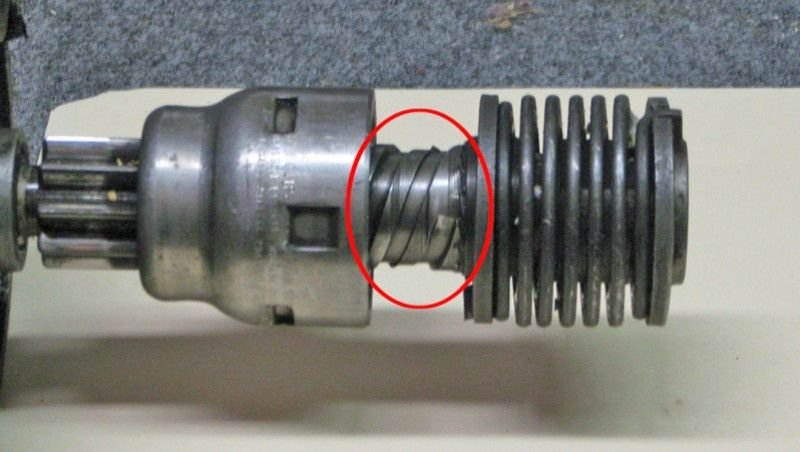

Got the bendix freed up but I am confused. When I first worked it back and forth I got the gear portion to come nearly all the way down the spiral towards the spring. Now it wants to stop with a good amount of the spiral still showing. Seems that it is moving enough to engage/disengage the gear bit wanted to ask if this was normal before I put it back in. Picture 1 is all the way engaged, 2 is as far as it will now disengage.
Engaged
Disengaged

Pretty sure that the flywheel slings the Bendix back to disengage once the engine starts.
That is correct, and you will know it if it doesn't.
