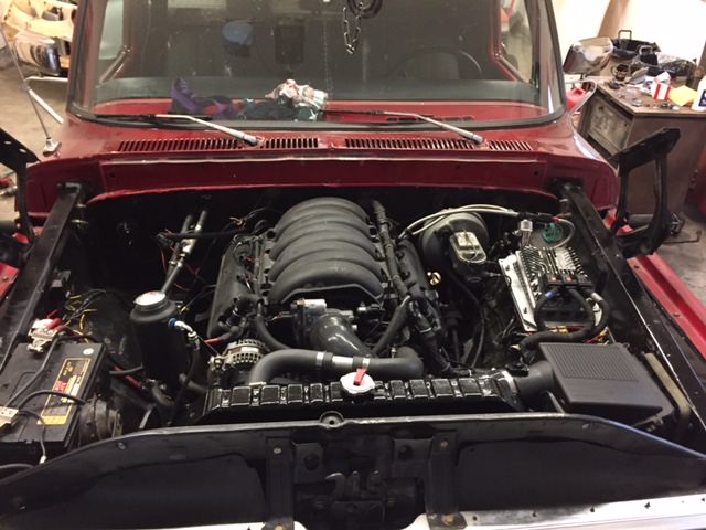

Small block chevy gen 5. more power and double the mileage of a 460. Bolts in to these fords, factory 11:1 compression and 6 speed automatic.
Attachment 286821
LOL sorry couldn't resist.
