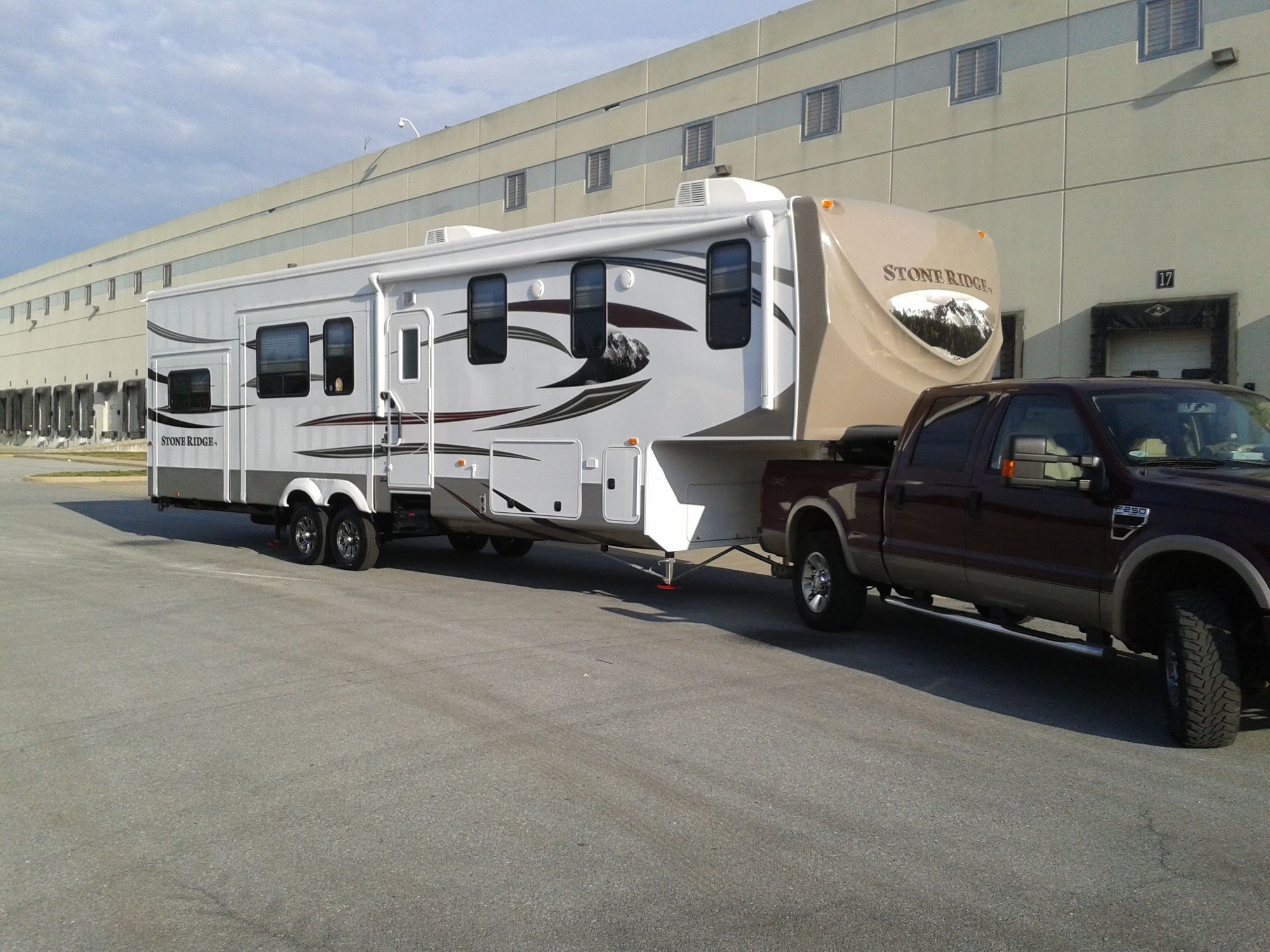

Sure, my F250 will pull that trailer. Hehehe...
My truck pulls it just fine.
