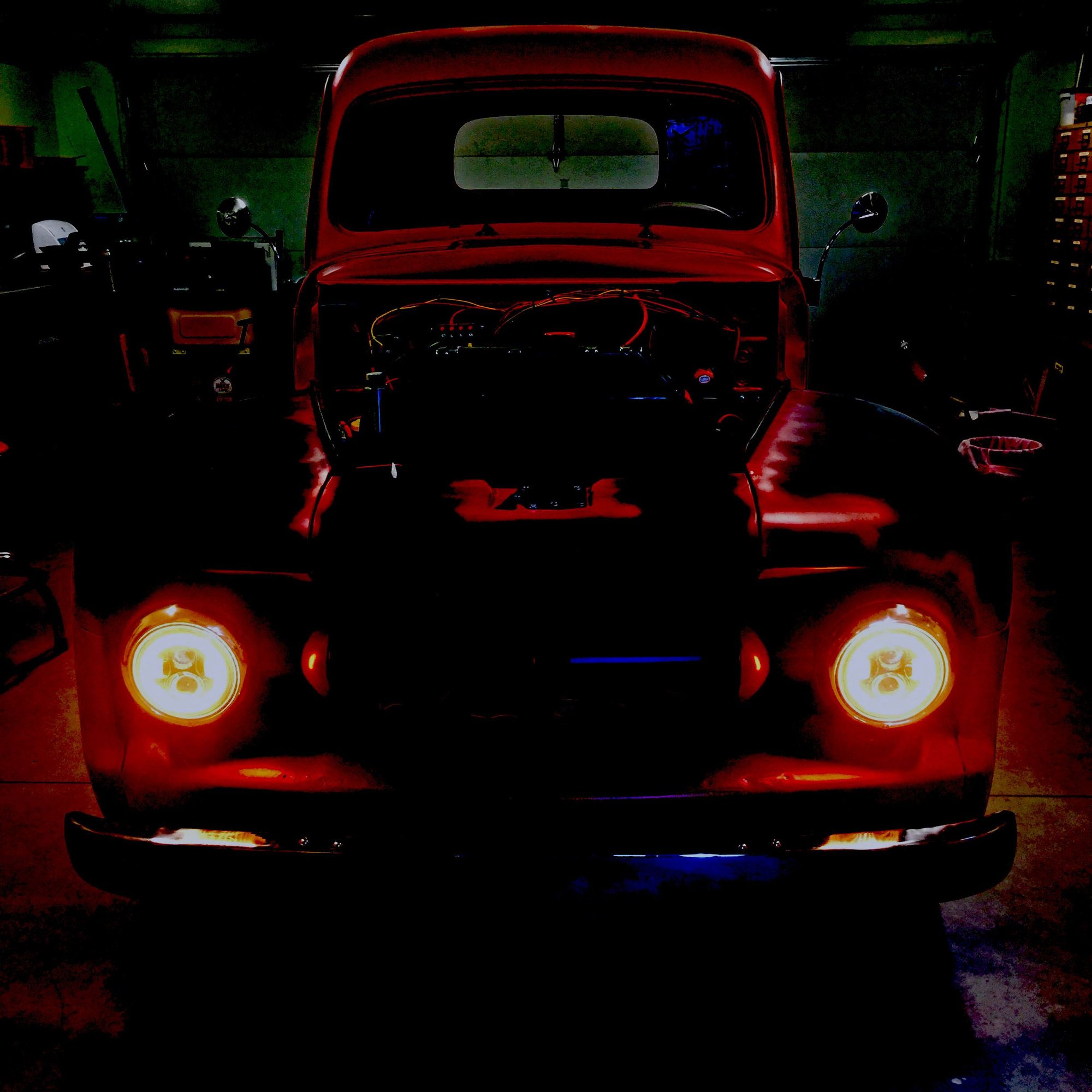

They should fit as these 7" fit my '50 just fine. $41 on eBay. The only issue is that you must run the white as DRL as the white halo provides power to the amber halo.
