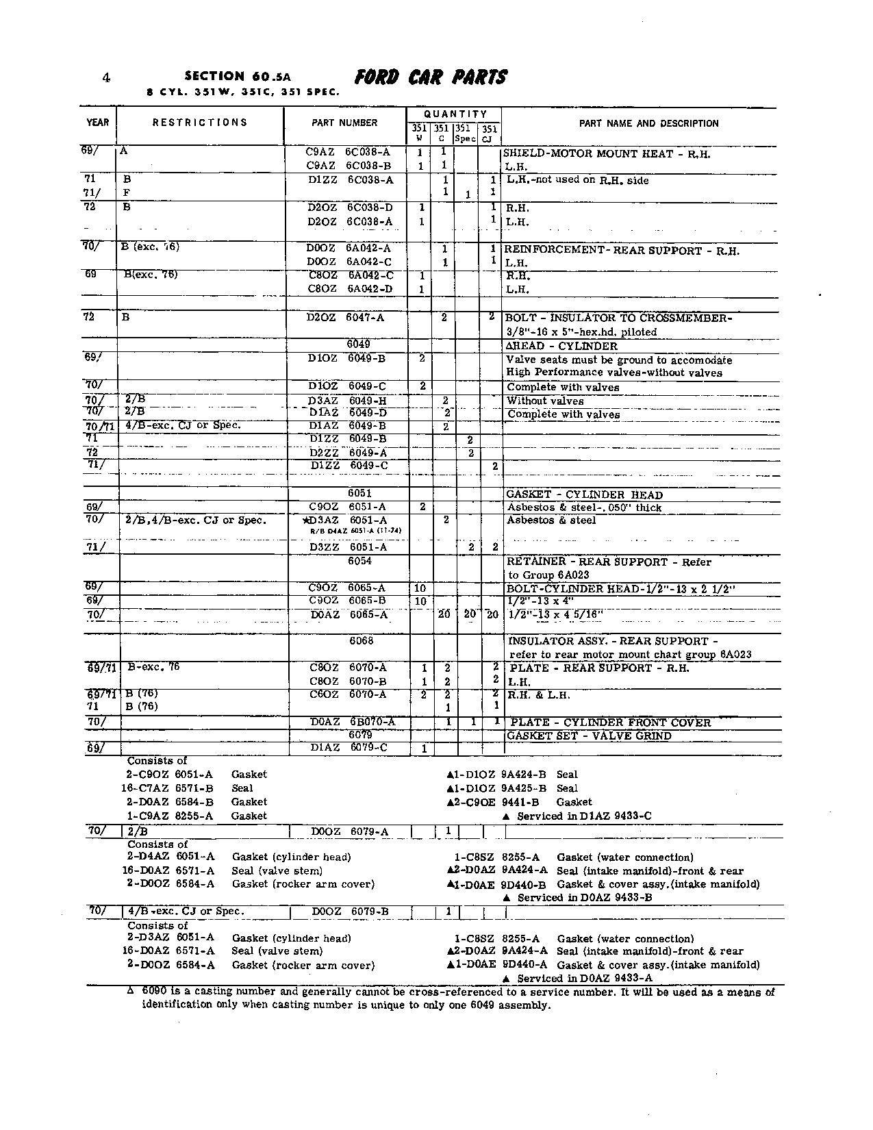

Pic: 351C/351W: First page of engine section from the 1965/72 Ford Passenger Car Parts Catalog.
Ford/Merc Passenger Cars: 351W introduced in 1969, 351C introduced in 1970.

Interesting information. I see at the top of the sheet that 351W, C, Spec and CJ are listed, but in the rest of the listings I don't see how one can tell which engine the parts are in reference to.
And what's a 351 Spec, is it a C or W?
Read down the columns where it lists the quantity of the parts to determine which part fits what engine.
The '351 Special' is a 351C since it has a flat engine cover plate in lieu of a timing cover.

Okay, got it. That second image makes it more clear.
Look @ the crop below. The chart has 351W, then 351C. Anything to the right of 351C is still a CLV.
FORD uses the term SPEC (SPECIAL) in cataloging to ID a performance engine.
The 351 Spec was the 351C BOSS 351 (1971) and the 351C HO (1972).
The 351CJ was a low compression 351C 4V performance engine (1971/1974).
The 351CJ git it's name as the camshaft profile was a copy of the FE 428CJ.
