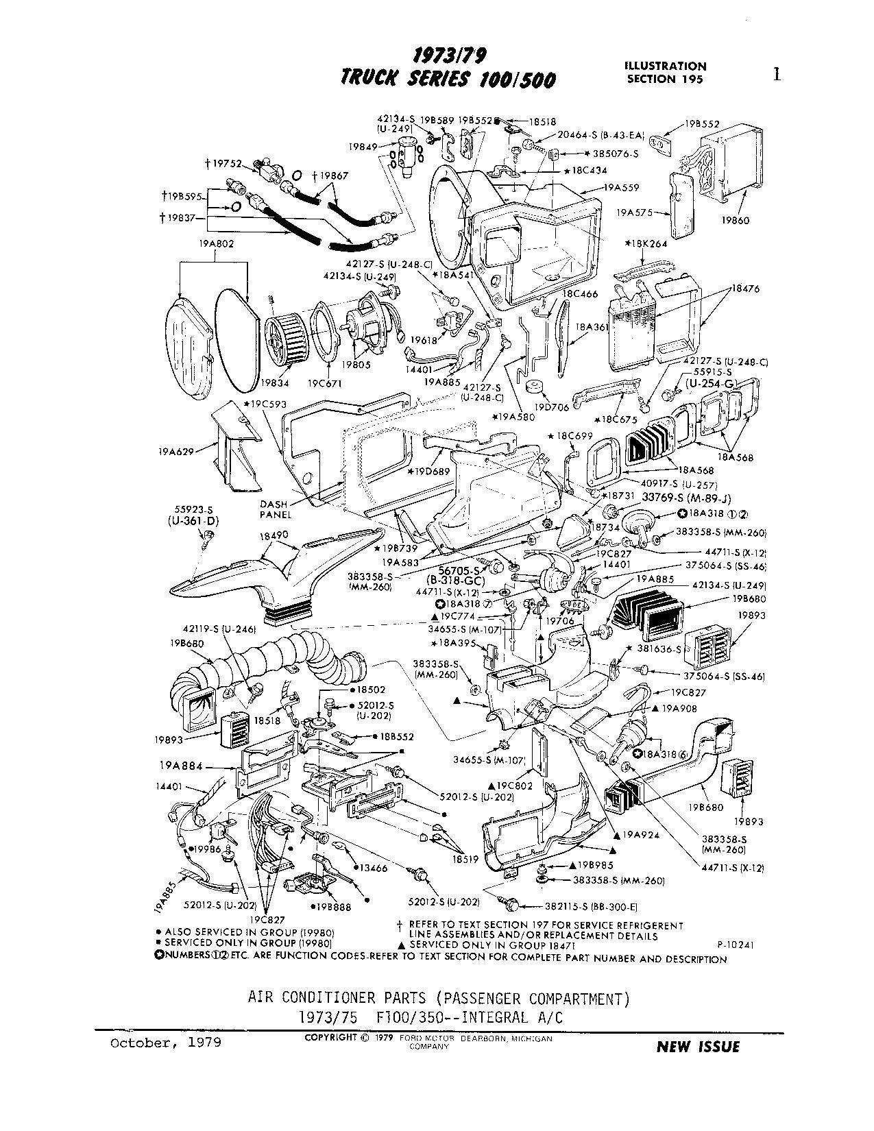

How destroyed is your big under hood heat / AC box. With pieces from another one, a lot can be patched, a bit of J B Weld or pop rivets, some paint, no one will see it.
77&79F250 might have just what you need?
A few things .... going from the big under hood heater / AC box to the all under heater will mean ....
  • fixing something for the big hole it will leave in the firewall. If you want the heater right, it'll mean grafting in a section of firewall from a heat only truck, of fabricating accurate holes and the recess at the heat blower motor.
  • rendering the dash face vents useless
  • leaving no vent for the driver as the AC trucks do not have a driver side kick panel vent as I recall (a vague recollection but seems to me that the '73 and '79 trucks I robbed of AC components did not have it) .... (please correct me if I'm wrong about the driver side kick panel vent)
  • includes changing controls
Even if you replaced the busted heater / AC big box, I think would be easier to do and more rewarding, even if one doesn't put the AC parts in too. At least you keep vents and they do vent well even on a hot summer day (which is why I put a "ball valve" in each heater hose to keep heat from migrating to the core). If you are thinking of pulling it out and just plating over the hole, you'll lose heat and defrost too. If the day comes that I must R & R my 1973 heater core, I'll take the opportunity to remove the AC evaporator too.
Was a time I wished I hadn't converted from heat only to heat / AC, but then I realized the vents made it worth my while. Had I not converted, I'd still have my kick panel vents (pass side on non AC has a vent door too) but until I drove my truck without a hood bug shield (it was on the truck already) .... it was like an oven in summer, vents did not vent, so I did the AC conversion. At some point, I removed the bug shield for some reason (maybe it broke?) and suddenly, my vents worked. it wasn't cold air like AC blew, but it was moving air.
Just all that to say "think about it".

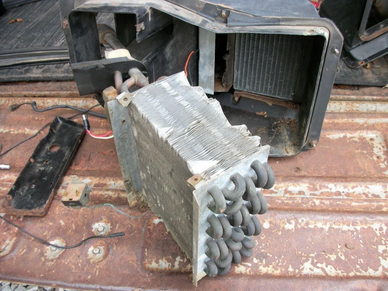

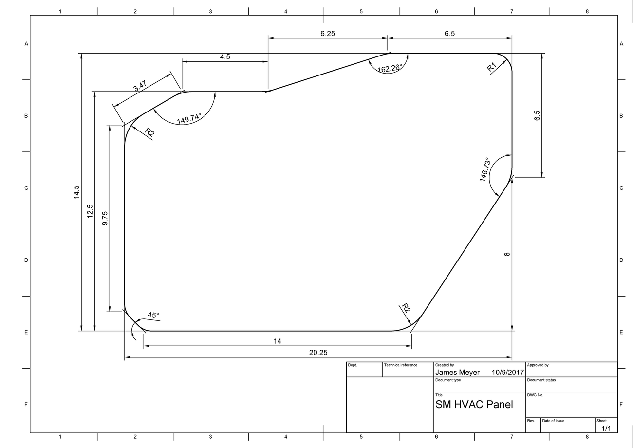

I have one parts truck that is none a/c. And I have a firewall that is also none a/c, if you want your patch panel cut from a trucks firewall that is for heater only.
Heater only.
The patch panel if you are going to just make it.
Once the giant evap box is out.
And BEHIND the front a/c core id the heater core, deep inside.
Bue circle is the blower motor and blower wheel.

yes I want to cut a panel from a non AC truck rather than make the panel because it’s recessed where the fan motor protrudes also there the heater core lines protrude.
