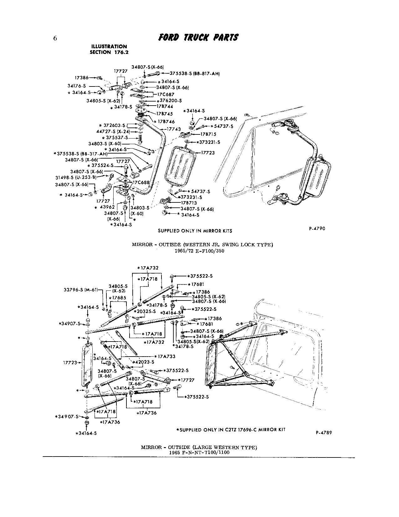

I have this kind of mirror.
The spring (if that's what it's called) with detents in it is broken and the wind always pushes it into the door. The mirror is useless. Can this part be gotten and swapped in? That's the top of the mirror BTW.

Jr. west coast mirror. Hopefully someone stops in and offers you parts. Doubt if any factory parts left in the system.

Yeah that wave washer is the spring. I"ve seen them in salvage yards.

There is no spring with genuine Ford Western Junior 'swing-lock' mirrors (that have 3 embossed lines on the mirror head).
Upper (upper) pic:

He needs: 17B745
The metal washer that has the detents to hold the mirror in position.
"IF" it is not actual springs steel, then it could me made from some 16ga steel and replicated in some manor. The factory piece is likely stainless, thus it won't rust.
And, "IF" it is not spring steel, removing it, having someone put a touch of weld on it(TIG it), would fix it also. Might distort, take some finesse to straight it, but doable in a pinch.

He needs: 17B745
C7TZ-17B745-A (replaced C6TZ-17B745-A) .. Rear View Outside Mirror Pivot Spring - Stainless Steel - Use with Western Junior Mirrors / Obsolete
1966/79 F100/350 & Econoline.
NOS PARTS LTD in Waxahachie TX has 8 = 972-937-2201.
