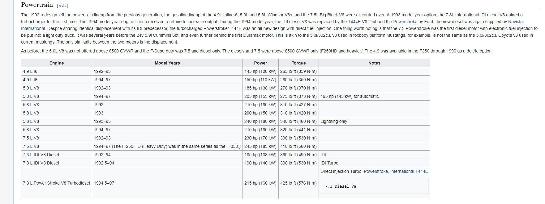

I've gone through my bookmarks, as well as a site search & cannot locate a scan of a Ford Engine output lineup that gets posted regularly.
Anybody have it?
Here's a Wiki screen grab of engine outputs that I thought would be useful for benchmarking:
