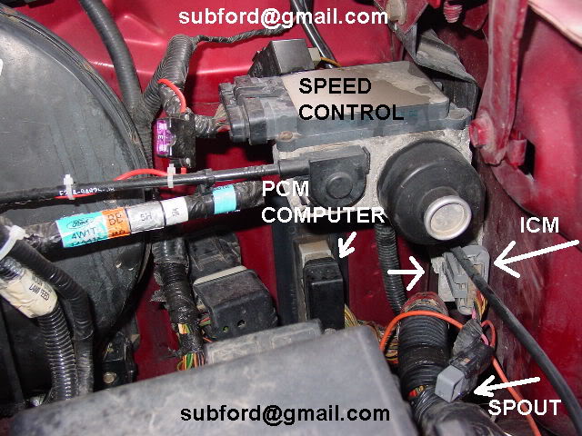

The SPOUT:
Attachment 284976
PIP: Profile Ignition Pickup. A "hall effect" vane switch that furnishes crankshaft position data to the EEC-IV processor.
SPOUT: Spark Output signal from the EEC-IV processor.
