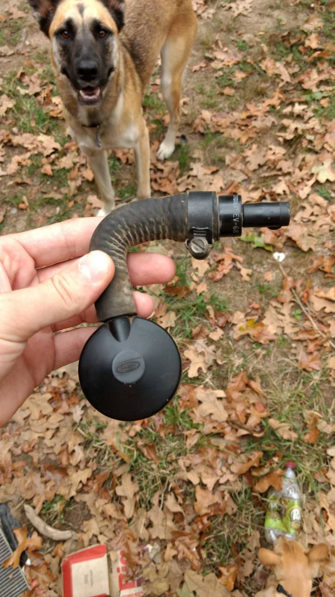

Originally Posted by F-250Flyer
As goinboarding stated, the baffle in the valve cover is very important. Pull the PCV hose and see if oil is dripping out of it. Did you move the PCV location?
Did you install the rings? If so, did you stagger the ring gap, especially on the oil control rings?
Did you check for cylinder taper? Did you check ring end gap?
PCV is in same location, but I removed the "hockey puck" (Breather?) and routed everything like the 302. I just pulled the PCV valve, and it does indeed have oil dripping out of it. Any other reason as to why it's sucking so much oil up into the upper manifold?
I did install the rings. They were clocked and checked for tape and end gap.
Am I correct, - you do not still have the breather in place? Is the PCV valve sitting in the valve cover like a BIG vacuum cleaner hose, with no baffle between that and the oil from the push rods/rocker arms?
If so, install the ( hockey puck ) or switch valve covers if the other one has the baffle. Remove the plugs and clean them all ( when you get the double joint spark plug socket ) with carb cleaner and rinse with brake clean. Reinstall them and see what happens. Remove the puddle of course from the intake plenum. Clean all the oil from the PCV valve and hose also.
Before you start the engine, temporarily put a piece of an old white t-shirt over the "exit" end of the PCV valve and reassemble the hose, run the engine for a few minutes, remove the piece of t-shirt, and see if it is still sucking up oil. The t-shirt piece may have a small amount of oil on it but it shouldn't be saturated.

Correct, the breather has not been in place since this engine has been installed in my vehicle. The 302 did not have a breather so I just routed everything like that. I looked down the hole in valve cover just now and there appears to be a baffle, but I suppose the breather still needs to installed. I don't see this breather on stock 351's or 302's for this model and vintage however. But there definitely is a lot of oil in PCV valve and hose and big puddle collecting on bottom of upper intake plenum. Is there any other reason why oil is being sucked through the valve and into intake that I may be overlooking? I'll get a hold of a new breather and will clean everything up as you suggested as see what happens.
