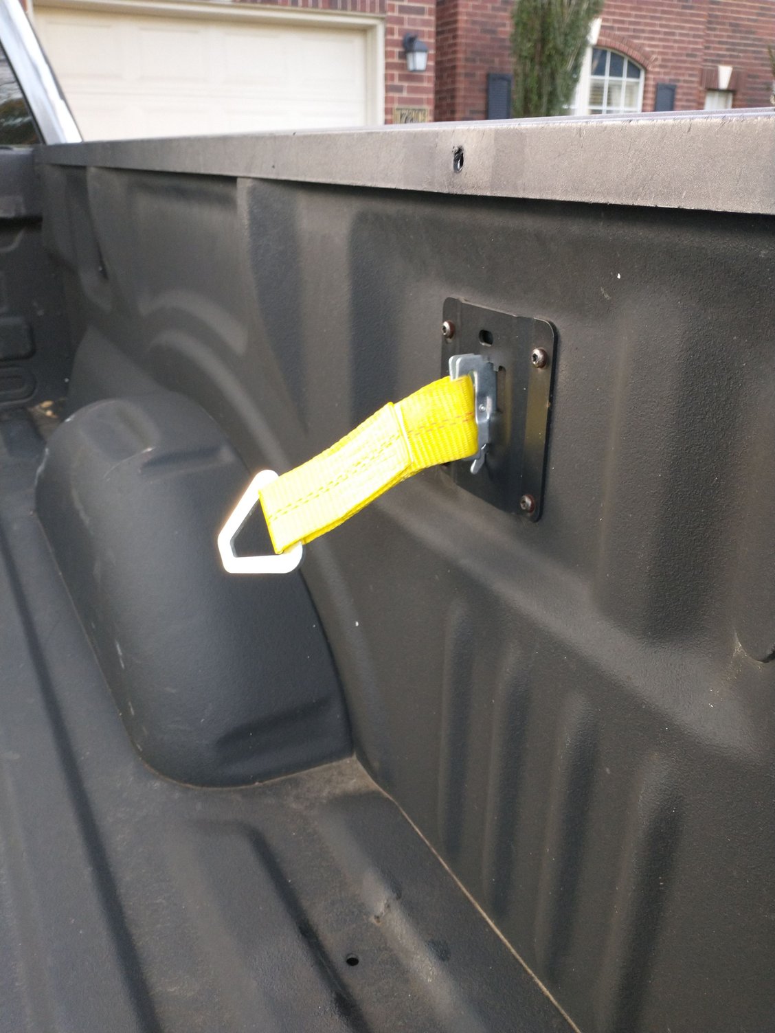

I bought just the plates from Amazon for $20 and use E Track heavy duty rings that were $4 apiece. Easy in and out, I store the rings under the back seat when not in use. Amounts to four additional tie down locations. IMHO a very useful set up!
Timm
Do you mind posting up a picture of how it looks with the E Track stuff in there?

Smile E Track rings
I use the E Track rings also. Get them at Home Depot (https://www.homedepot.com/p/Keeper-7...7801/207097639)
They work great.
