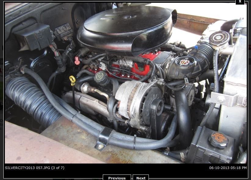

I bought my ductwork from either Graniger or Fastenall for my 47 cadillac, I will have to double check. I bought a few sizes including larger hoses for my air flow system.

Do they have the same size & style in 4 " ?
