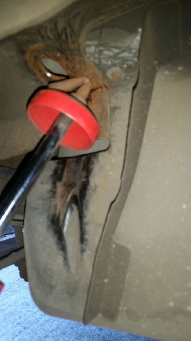

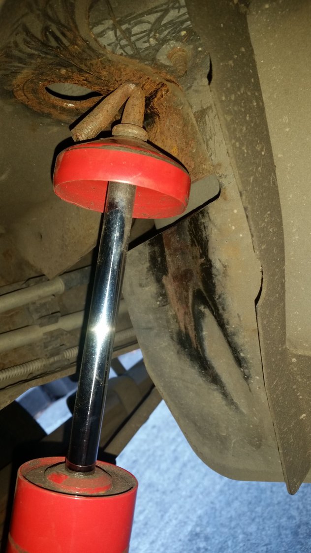

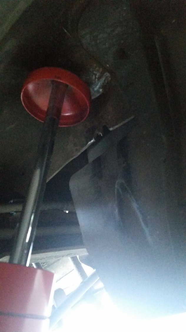

What would cause this? Guess its time to replace.

Could be any of these reasons and more. One thing I don't see is a nut on that shaft so maybe it wasn't installed correctly, looks like it has been rubbing on the opening for a while too so who knows. I don't envy you either way shocks are a bitch to change on these Vans.

Looks like improper installation.
There should be a large washer and rubber grommet on either side of the rusted out hole in the frame. Either the wrong parts were used or it was installed incorrectly.
And it has been getting beat to death based on the visual. That had to make a bunch of noise for a length of time that would exceed the time it takes to drive around the block.
