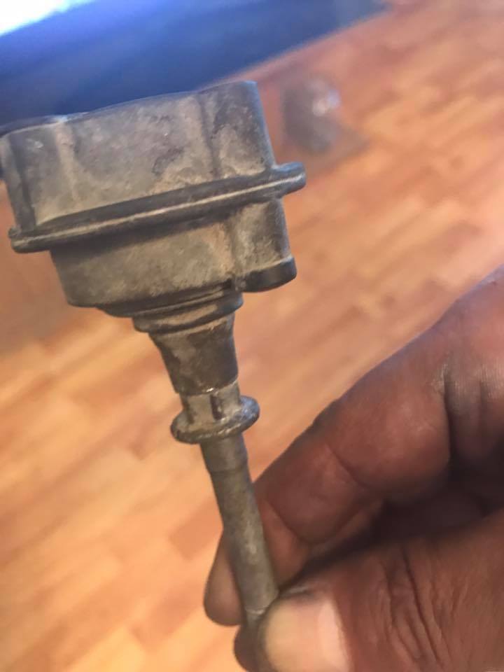

i just bought a 2011 ranger truck(used of course).
I was doing brakes because i did not know who had the truck before me.
Question:
Why does the brake caliper bolt look like this?
I have never seen anything like this before on any car i have ever had.

the ford parts says it is an axle damper
how can a bolt on a caliper be an axle damper?

Hmm, I don't think I've ever seen one like that either. My '04 Edge doesn't have anything like that. Do you have 4 wheel discs? What end did that come from if you do?
Only thing I can think of is it'll allow for caliper movement?

that's a vibration damper. takes care of some noises/groans/squeaks. can it be removed from the bolt?
EDIT:
its in the Fordparts.com catalog. axle shaft damper, 4A263, and apparently can be removed from the bolt.

Looks like what we used to call "caliper slide bolts" according to the exploded view.
