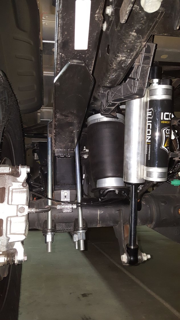

Finally, all hooked up and everything was perfect. 30 psi in new long travel air bags from onboard air. Thought truck and trailer sat just about perfect. That trailer has 160 gallons loaded up along with everything else. Pulled great. Only thing really different from all my previous Super Duty lifts. The steering seems really light. I'm wondering if it's the adaptive steering???

Is your truck leveled? If so, the caster angle needs to be restored. The steering will feel light and floaty if there's not enough caster on the steering knuckles.
