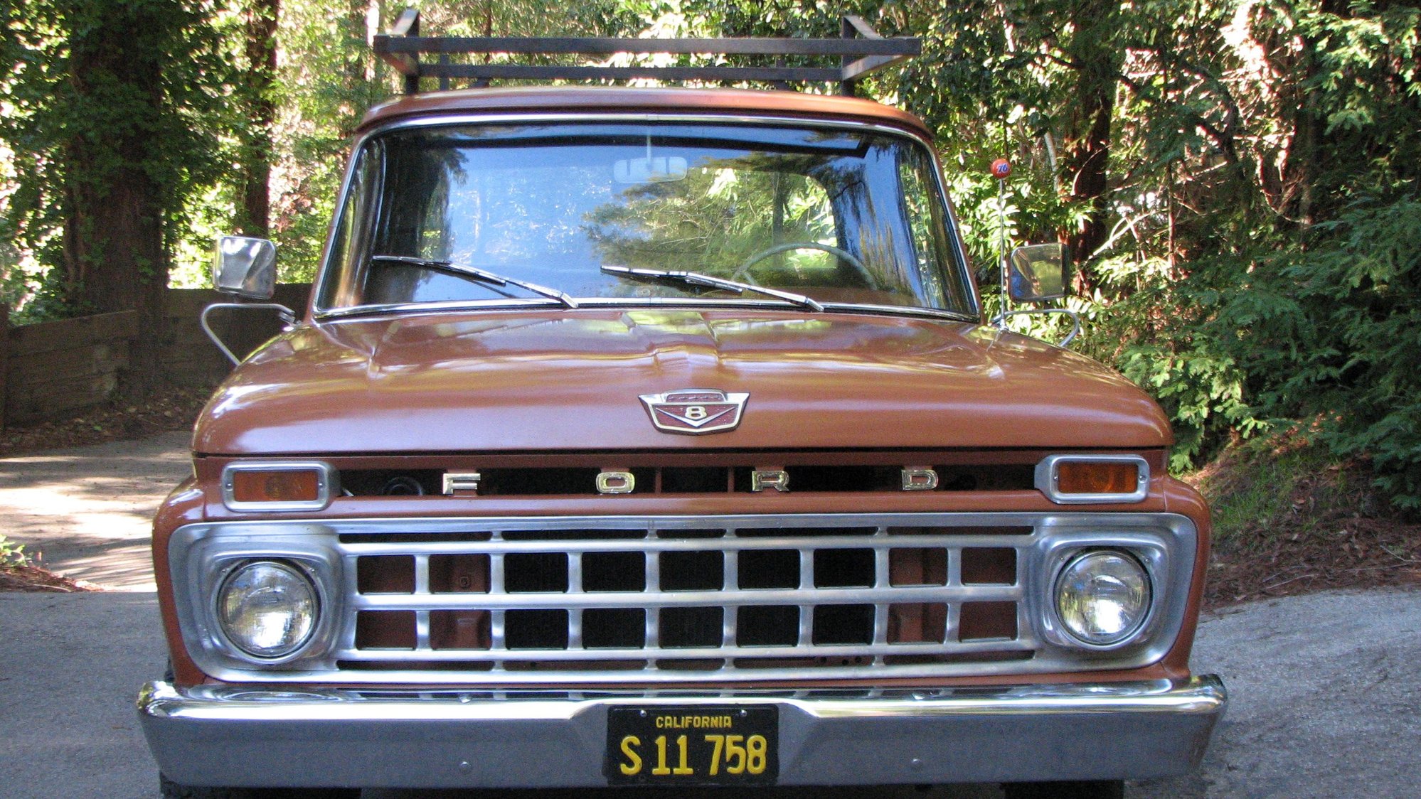

From my experience the alum. anodized grille will last the life of the truck with minimal upkeep.
Took 65 alum. grille in years ago and suffered from sticker shock when platter quoted the cost. Considered chroming and the platter advised otherwise, unless I intended to show the vehicle and not subject the highly polished soft metal to road debris? I decided to strip anodize, sand, polish and found far too labor intensive.
I have a couple steel 65 grilles and have not gotten around to having them powder coated, over the phone platter suggested anywhere from $150 to $200 depending on condition?
