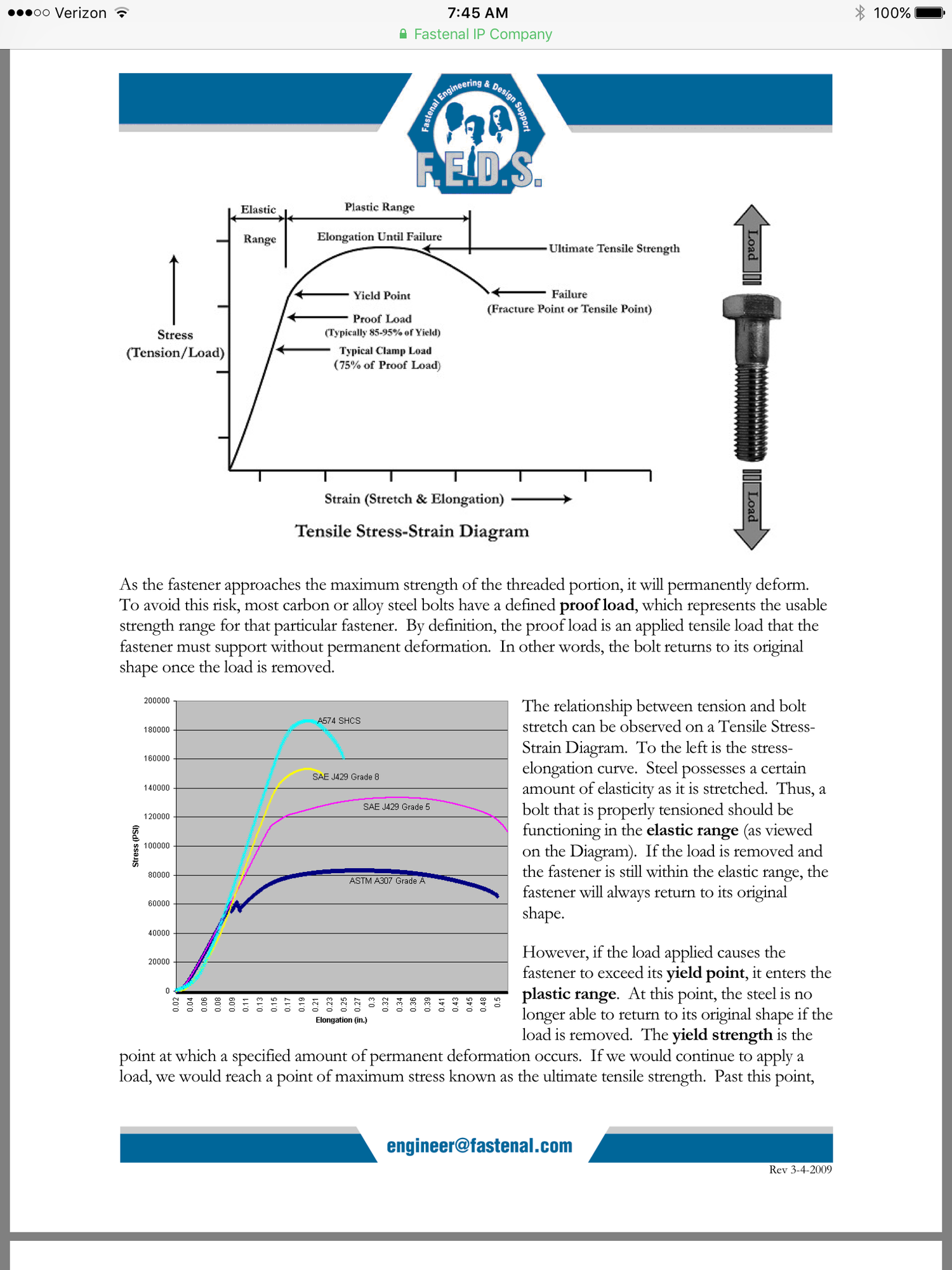

They have to stretch in order to do their job. The difference between the ARP studs and stock TTY is the grade of steel and heat treatment, so the stretching-strain curve is different. Fastenal has a really good document about the engineering of fasteners, but here is a quick image.
https://www.fastenal.com/content/fed...t%20Design.pdf
Fastenal also talks about reusing threaded fasteners.
https://www.fastenal.com/en/77/reuse-of-fasteners
I've never used the ARP studs but lubrication is very important to getting the correct amount of elastic stretch. What I would be more concerned about rather then the stud is the nut. In structural applications while bolts can be reused, the nuts cannot due to the thread distortion noted above.
