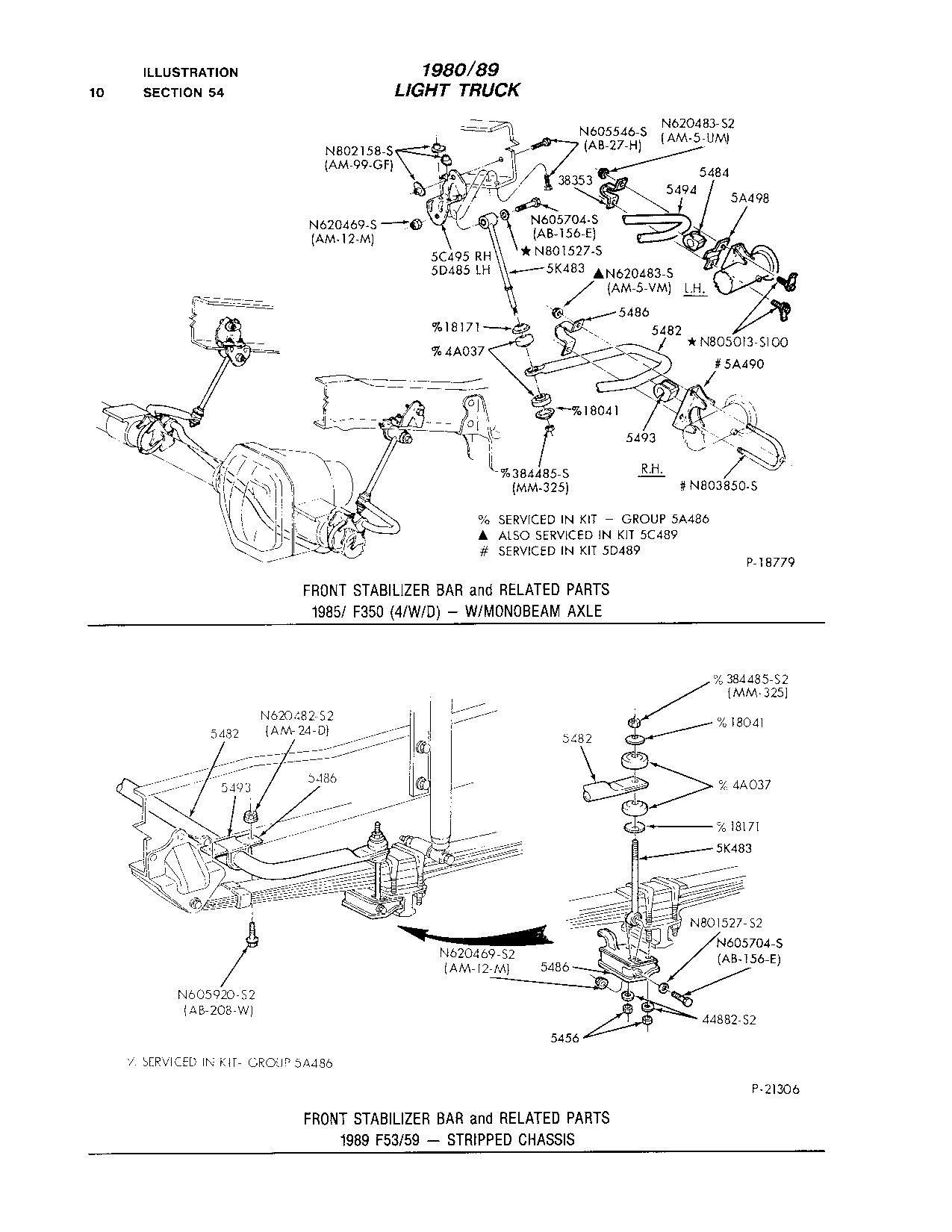

Originally Posted by crucialprospect
Numberdummy-what's the number WITH the moonbeam? Thanks!
E6TZ-5482-A .. Front Sway Bar- Use with monobeam / Obsolete
1985/91 F350 4WD
Upper pic:
