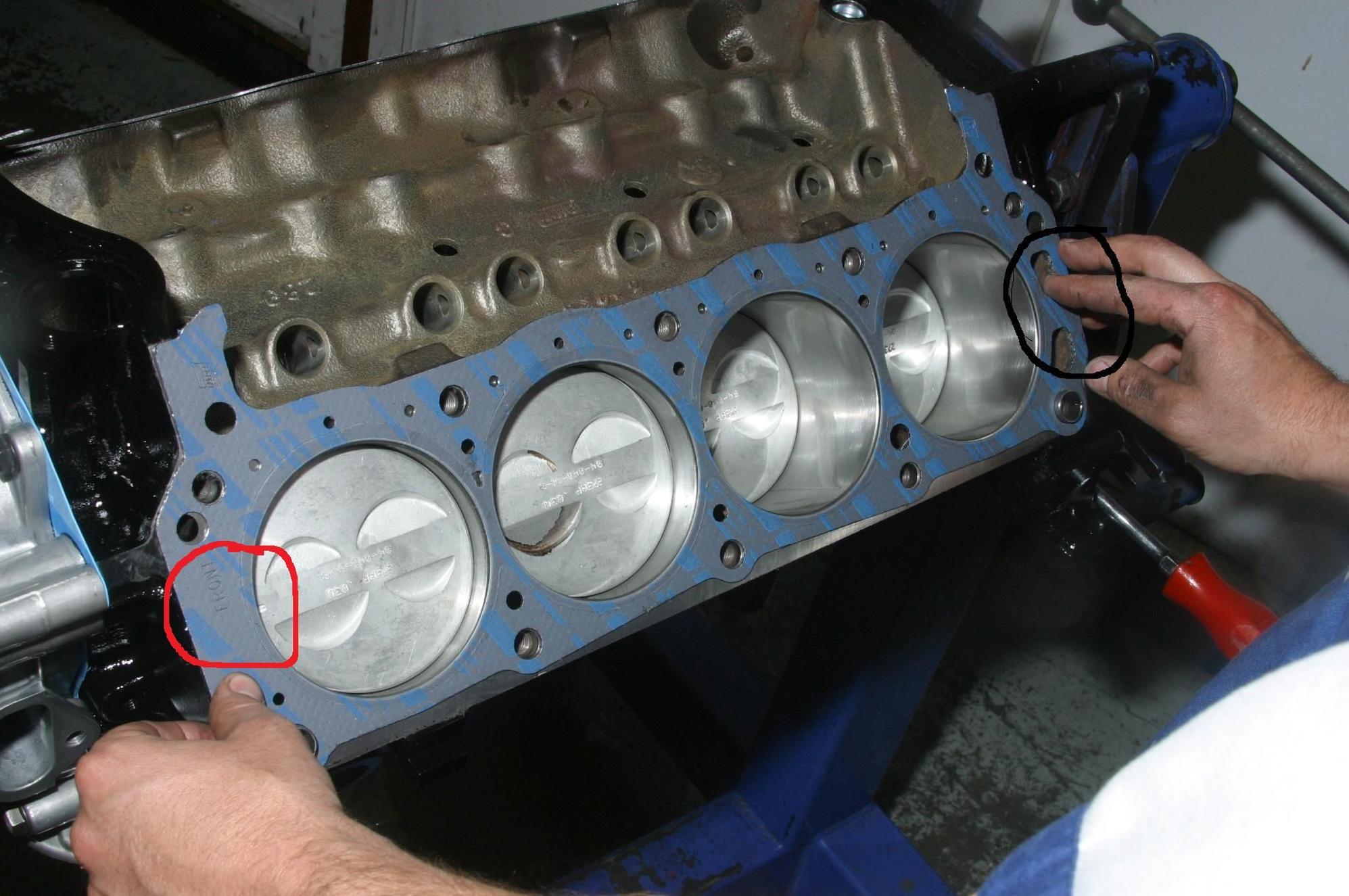

If you don't see the coolant moving inside of the radiator, the head gasket may have been installed wrong.
The gasket covers the water jacket holes only on the right side of the picture.

I'll bet you Gary nailed it on this one.
OP,If he's right you ought to REP him for it.
