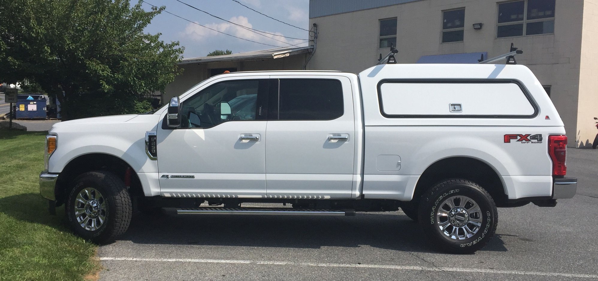

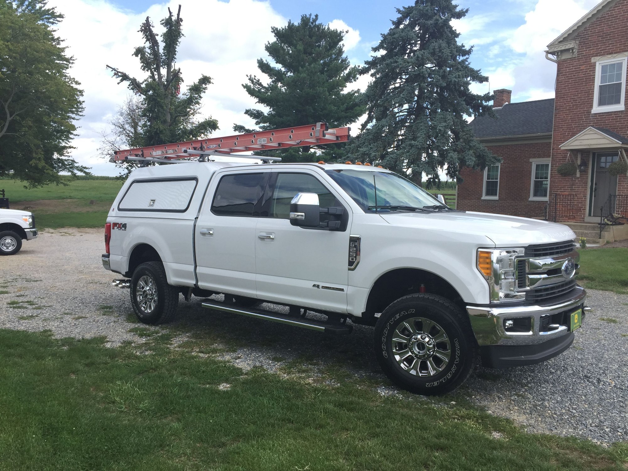

I am an electrician as well and just had a Leer 180CC commercial cap installed with CapRac ladder racks. I believe the racks hold 400-500lbs ? The sides have plenty of storage in the bins.

Nice , that is my truck LOL. I am trying to decide between the leer like yours or the ARE DCU max cap. I like the looks of the fiberglass caps just not sure how they hold up in the Florida sun, my ladders don't like the sun.

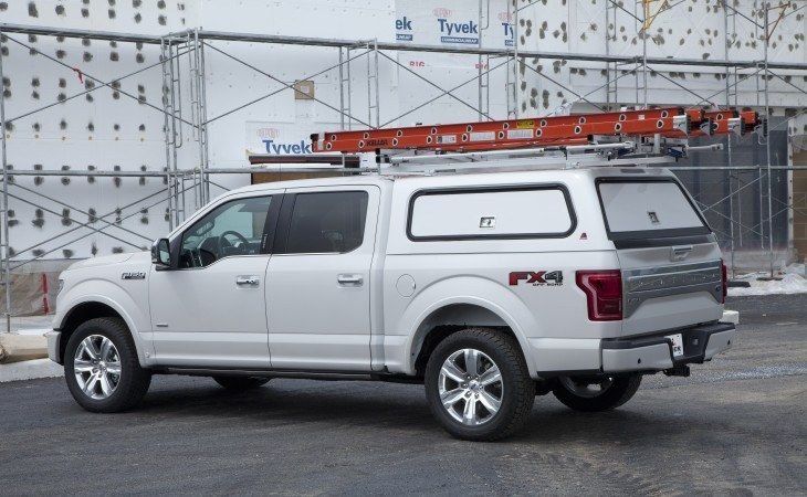

I cant work off of flatbed or utility bed I need enclosed storage. I'm looking at a cap and heavy duty racks along the lines of kargomaster II. (see attatched pic)Thanks for suggestion though all are welcome. I'm going from working out of a van for 25+ years. Theres a combo out there I just have to find it. This will probably work for me, I'm trying to find out if these racks will beat up the aluminum bed.

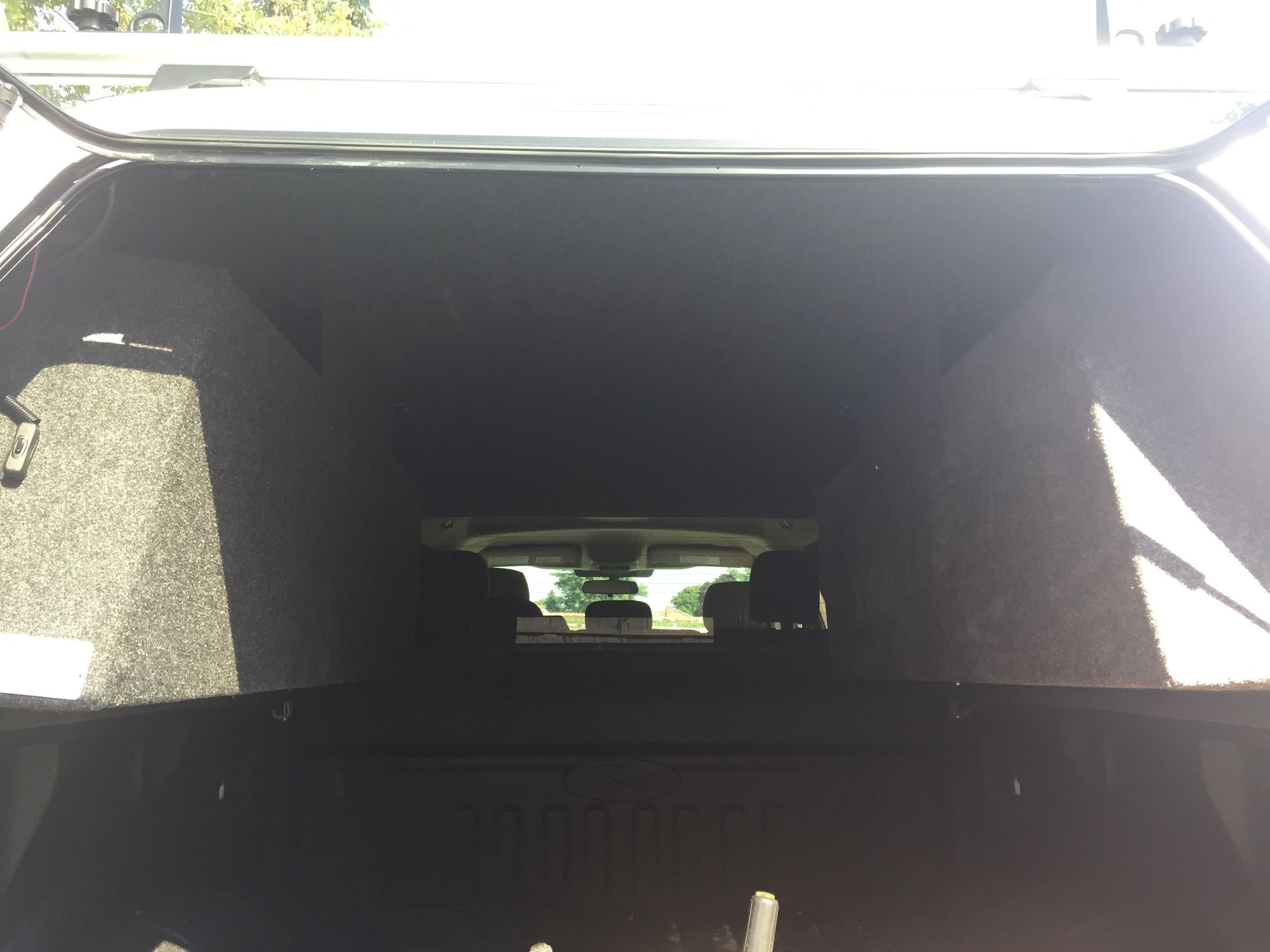

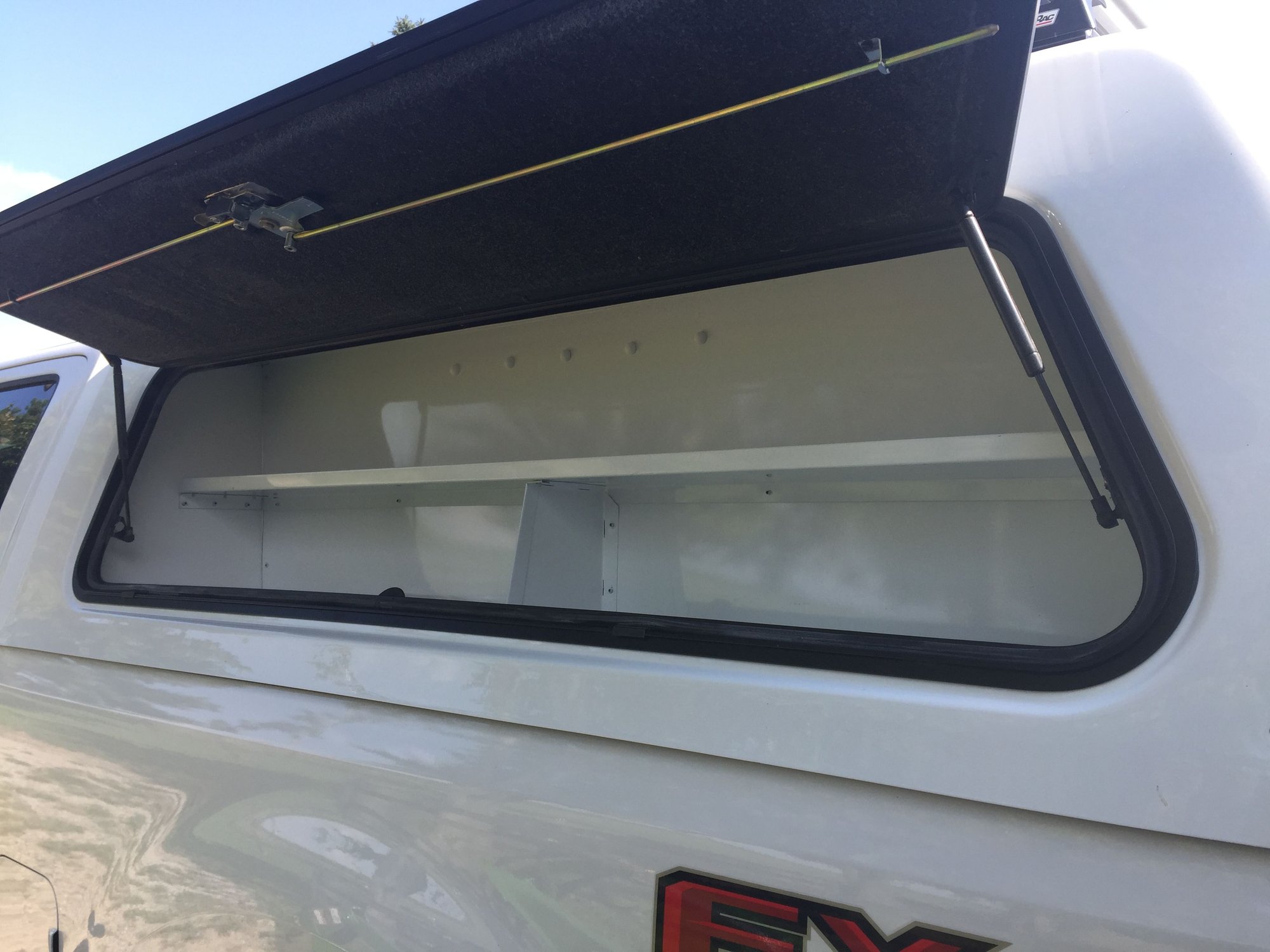

How is it loading ladders on top of the higher cap. It looks like the back of truck lowered a little bit from the weight? Mine is empty and looks higher in the back. Do you have any pics of the open toolbox, wondering what I can store in there.

How is it loading ladders on top of the higher cap. It looks like the back of truck lowered a little bit from the weight? Mine is empty and looks higher in the back. Do you .have any pics of the open toolbox, wondering what I can store in there.
The truck only dropped about 1/4-1/2", not much at all. Loading the ladders isn't bad at all, Leer also makes a cap like mine but lower (100RCC). They have multiple bin configurations and ladder racks to choose from.
Side bins
Back inside
LEER 100RCC
This is our first fiberglass cap, all of our other trucks have the LEER DCC aluminum caps. I wanted something that fit the truck better and looked a little more personal but was still tough and had the utility I need.
