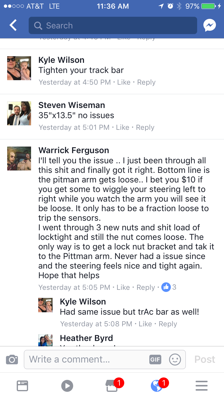

I have fought this issue for awhile. the dealership replaced a sensor re-calibrated it twice and it wouldn't go away. they then told me to take the dual steering stabilizer off which I did. that helped reduce the number of times it would come on. the last step was to check the pitman arm, which was slightly loose we got like 3/4ths of a turn out of it. since than it has never come back on. I even put one of my stabilizers back on. it's been a month now with zero Issues.

I do not have the amp steps. Just the standard power steps that come with the Platinum. I tried tightening Pitman arm, didn't appear to be loose but no error since I tried that. Fingered crossed.

so I'm lost now Ford says it was the amp steps but I disproved that already, they had no clue. Talked to my lift guy, they said apparently there are 2-3 different style pitman arms that can fit and he wants the truck to try all of them from full throttle. I hope this is the issue, I told him to try and tighten the current pitman arm as many have suggested on here. I'm just lost and frustrated at this point. I'll keep this updated once I hear back

ya it appears fixed now. I had my lift guy retorq everything and the pitman arm to 400 footpounds. Hasn’t come back. I believe about 2-3 months now and used to happen every time I drove the truck prior
