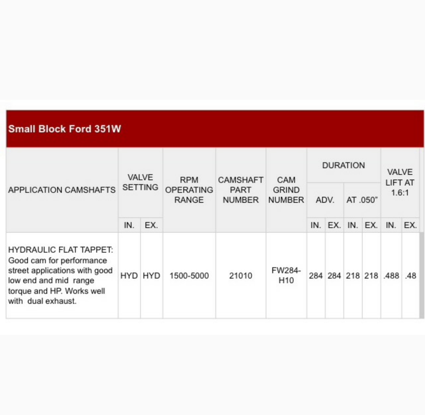

Here is the specs for the cam.

Conanski - Will swapping to MAF make the cam that much more livable? Is it just the idle quality that will suffer on SD because of the vacuum signal?
Instead of sourcing the parts for the MAF swap, you could put a more appropriate cam in the engine before putting it in the truck and be done. Swapping to MAF could still be done down the road.

The big thing is that MAF constantly measures airflow going into the motor and uses that to determine fueling requirements so it will better handle mods like a bigger cam. That's not to say it would make a big cam idle smoothly because it won't, but it will do a better job of delivering the right amount of fuel at any give rpm/load.
