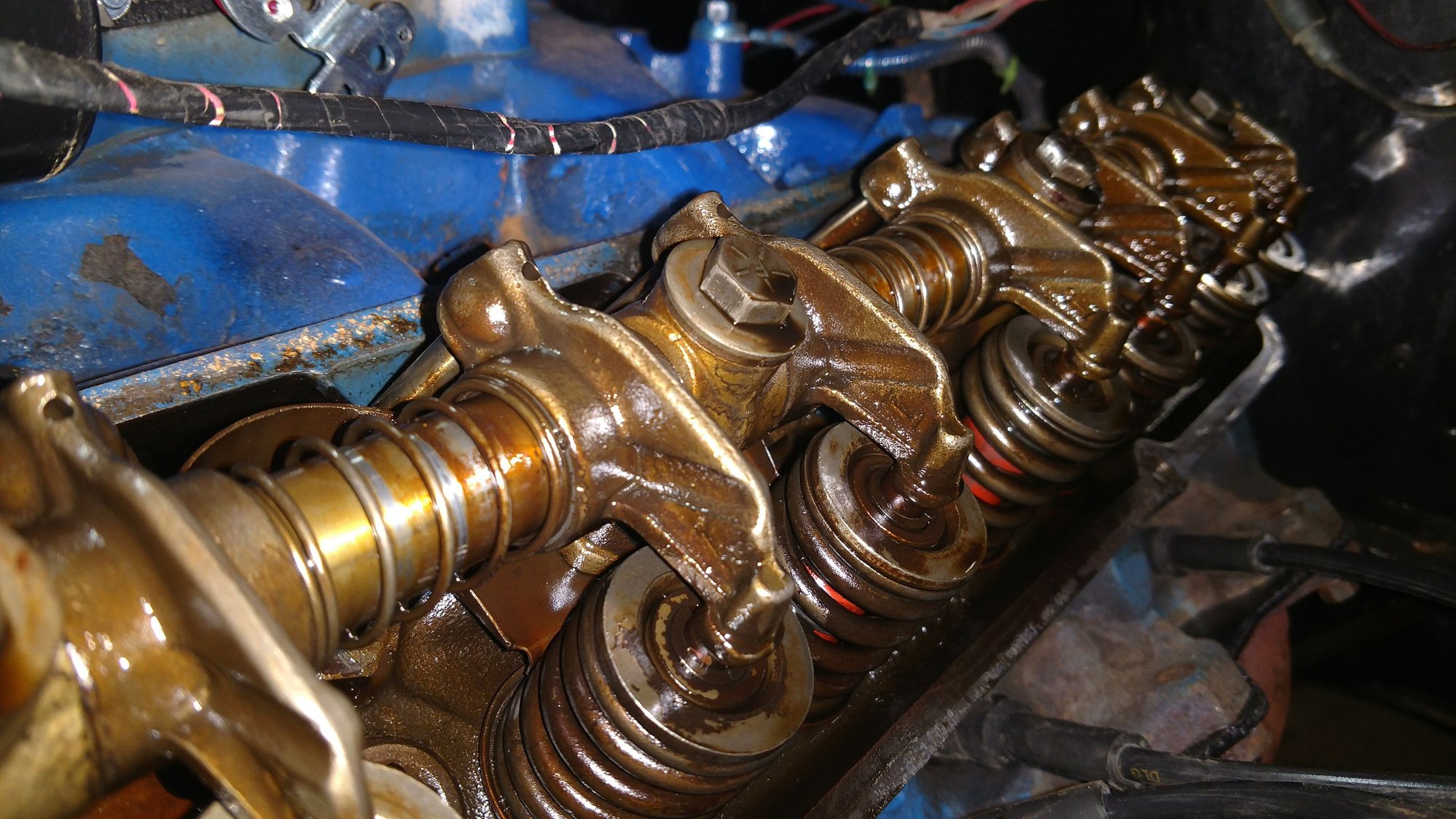

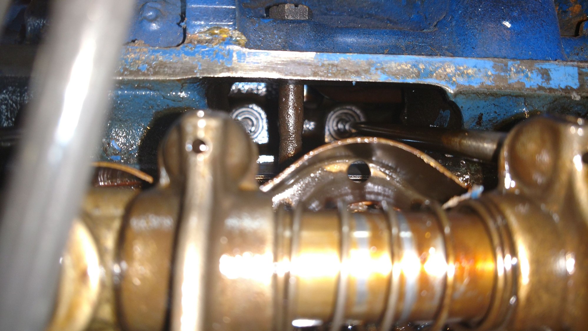

So here are some pictures of the Valve train and from what I can see its pretty clean in there.

Originally Posted by JRB64
I took the Valve cover off and I found nothing out of order under there. I did check the torque on the Valve train bolts and one of them was pretty loose and I torqued them all down to 45 Foot Lbs. Its still missing and Im at a loss. I guess if I had a bad valve it would be impossible to see without taking the head off. unless I wanted to get one of those Crazy Camera's that you can snake down a hole.
Are the pushrods bent on #6? Or loose?
I was able to spin one of the push rods but the other was under load so I have no Idea if it spun or not. All the pushrods on the valve bank were snug but I could spin all of them. I guess I should have Turned over the Engine and Watched the valve bank to see if all the valves were opening and closing... I need someone to crank it for me so I can watch. The Pushrods seem to be ok, no bends or problems I could see.

So I decided to take the other Valve cover off to check the Torque on the valve rail and I found one of them stripped, and its the Oil feed bolt. Unfortunatley its stripped in the head. I found a place that sells FE 390 Heads for like $277 a Piece and I am about to pull the trigger on this. I was thinking maybe what I should do is pull the engine apart and do a Hone Job and put some new rings in it and with the rebuilt heads I cant go wrong. SD Parts - 2F20 FORD 360/390 CYL HEAD Engine Cylinder Head I could maybe put a new oil pump in it and a new cam. This kinda sucks but its not a huge hit just a pain having to pull the engine... Think I might put an Aluminum Intake on it as well.
