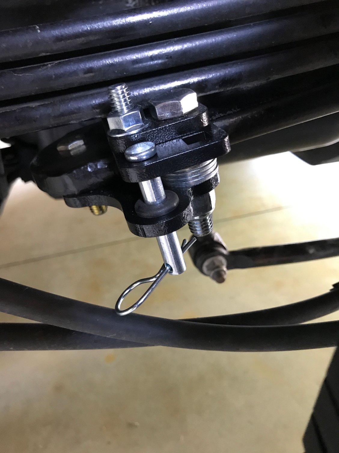

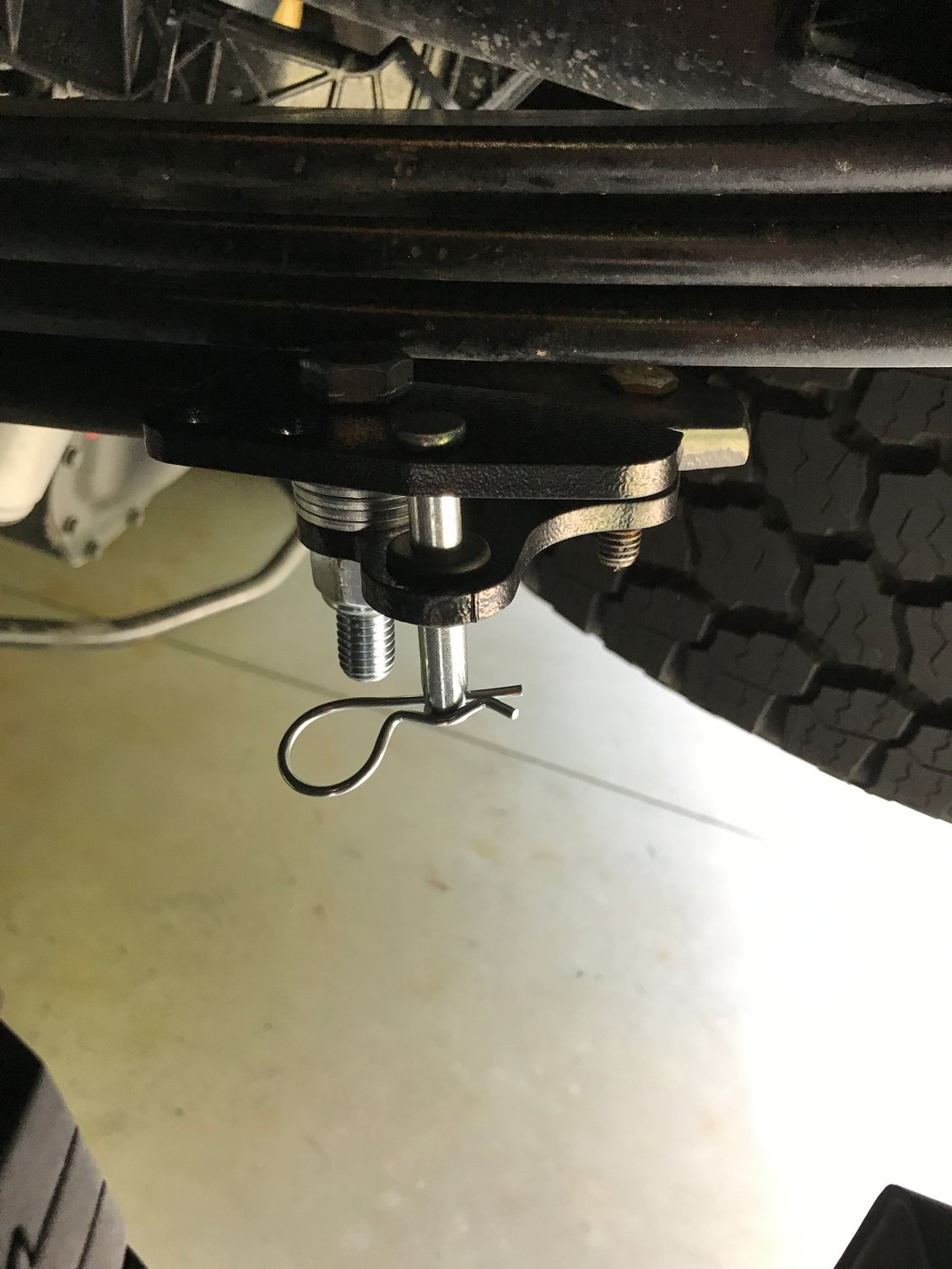

I've had them for almost 2 months but after my first attempt to install, I was ready to forget the whole thing. So, with a new plan (hire out the hard part) I got them in today quite easily. I had originally gotten the free rental of the drill tool that TorkLift will send you. You just pay the shipping each way. However, their Cobalt drill bits and my drill were no match for Ford's 2017 lower overload springs. After 2 hours I gave up on the first hole shortly before I was through...
Fast forward two months to today. I took my truck into a local spring shop that has been around for over 100 years. Ferrara Spring in Springfield MA. They had the first lower overload out of the truck and on their drill press in 10 minutes! It was drilled and back in the truck shortly after. I did have them assemble and install the lower plate of the StableLoads while the spring was off the truck to make things much easier when I got home. All in all, they were at it a little over 2 hours and home I went. I can't say enough about the knowledge of this shop. They work on anything from a small truck like mine up to big rigs, tri-axle dumps, etc. So, if your in the northeast, give Ferrara a shot...
Final assembly was super easy. Since the A7311 StableLoad kit is universal, you have to determine how many wedges you can use in each pack. Since the 2017 springs had a nice progressive rate to keep the ride soft while unloaded, the front and rear have different size gaps. The front took two of three wedges while the rear only took one. Now, the rear was easy as there was no way any more than one was going in. The front however, could be a tight fit with two or a loose fit with one. Either would have worked but I would have lost some of the value of the kit only doing one in the front. So, I decided that it was worth the 3 seconds it takes to open the gap with a flat head screwdriver when engaging the fronts. It's literally no effort at all with it missing by so little.
Anyways, they are in and ready for my next RV trip. I'll update the thread after my first tow them engaged. I've already taken two trips without them. One was about 150 miles each way and the other 400 miles each way. My 2017 performs head and shoulders above my 2012 already. However, it had just a touch of sag to the rear and over the bigger dips in the highway when the trailer would teeter totter on the axles, I'd get some bounce in the rear of the truck. According to other forum members I've chatted with, this eliminate about 1-1.5" of sag and cure the bouncing as well so I'm looking forward to putting them to the test.
Speaking of other members, I did find that I'm not the only one who had trouble drilling the 17 springs. Apparently, another member thought better of drilling his and since he was local, brought his truck right to StableLoad's facility. Well, even the guys who designed the product were astounded at how hard it was to drill the 2017 Ford lowers. They told him 1.5 hours to get it done and he got his truck back over 4 hours later. So, anyone thinking of trying these should strongly consider having a spring shop or someplace similar do the drilling.
Front disengaged.
Front engaged.
Screwdriver to allow front to squeeze in. Tight fit...
Rear disengaged.
Rear engaged.
