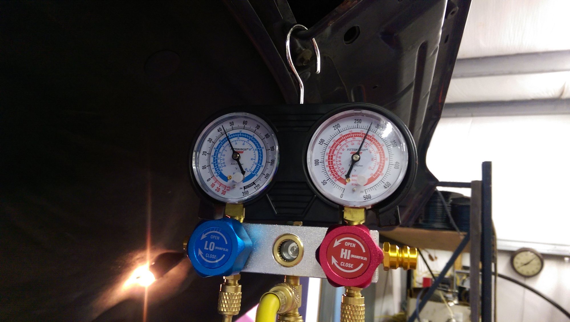

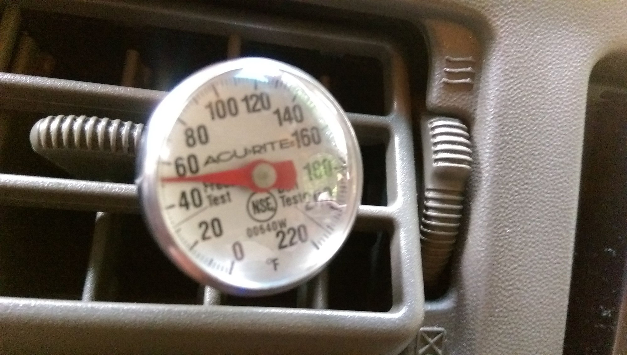

Vent is 58F, lowaide 29psi,high side 275psi after add just a little freon. Engine 1500rpms.
High side was 250 when I started.
Should I keep adding until I get about 45 or so psi or cooler air?
How high is too high on high side?
80F outside temp

Added a little more, now 32psi liw sude, 300psi high side. A/c atill 58F at dash vent.

Si I let it idle with freon on it, low side 45psu, high side 275psi a few mins then upped idle ro a 1500rpms, hifh side jumps to 350psi, liw to 38 with freon off.
Thi king I should go back to loidle ans wait with freon on?

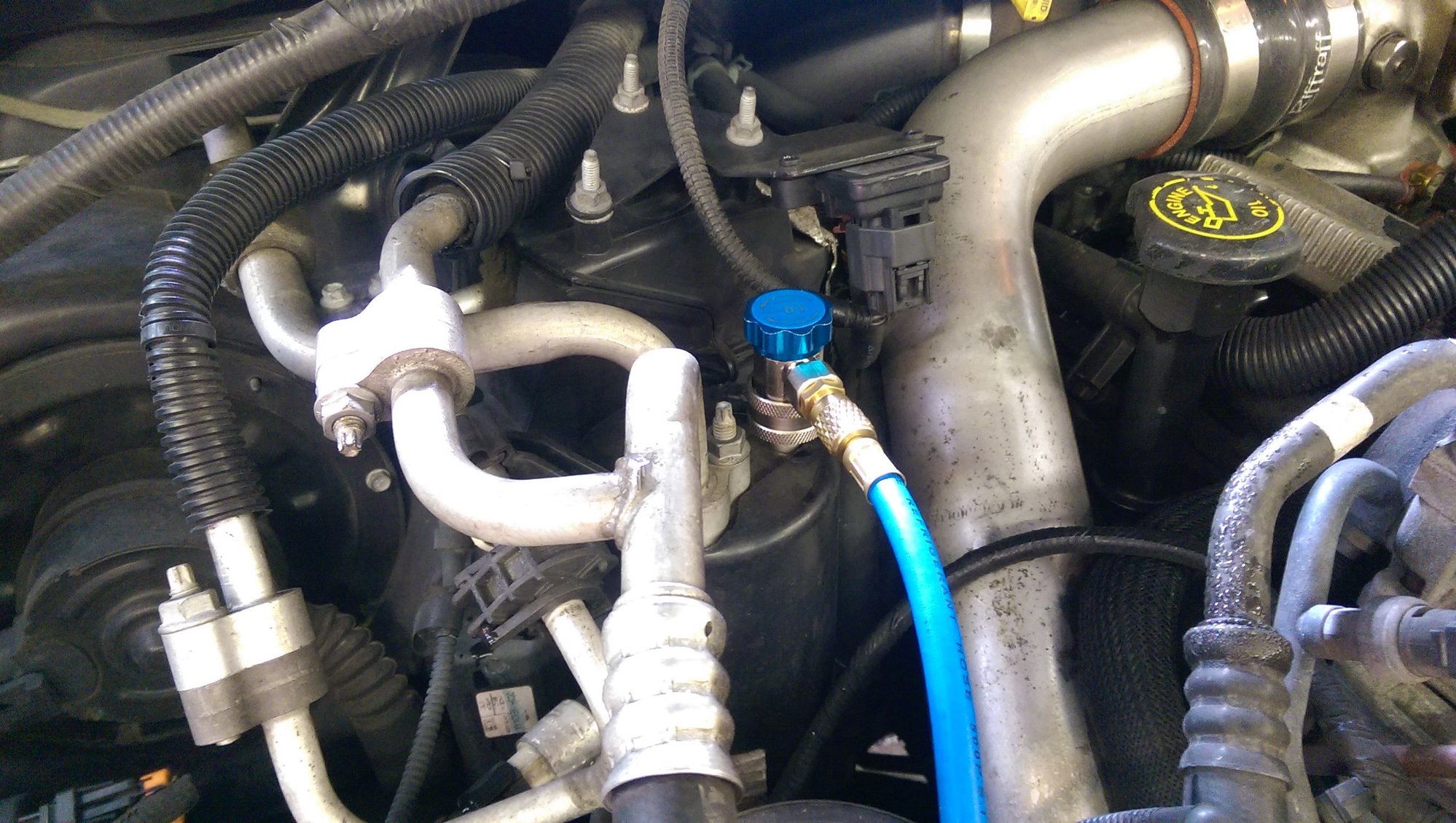

Bottle upside down, 1500rpm,freon open

High side is too high which indicates a restriction somewhere, probably a clogged orifice tube. Iirc, my high side is 175 at idle in 75 degree ambient and low side is 40. Low side pressure and temp should track pretty close with R134. Once evacuated, mine calls for 2lbs 10oz of R134 and 9oz of oil when I replaced the compressor.

I can get down to about 56F now, that's all...

This is all I can get.

Did you watch the sight glass while evacuating the charge? Mine looked pretty dirty. A new orifice is less than $10 and I circled it in your pic.
Remove the black safety clasp and then you'll need an AC/fuel line disconnect tool. Yank the tube apart, then you can pull the orifice out with needle nose pliers.
If the orifice is clogged, you should think about replacing the accumulator and flushing the entire system. If there's metal in the orifice, I'd replace the condenser too.
