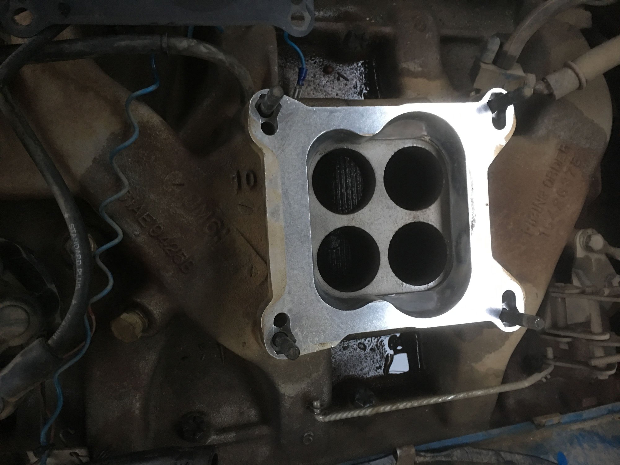

So I bought a 1971 Camper Special. someone has installed a 61 T-Bird Spread Bore manifold on it. I spent the weekend rebuilding the holley 4160 Square Bore and it leaks... Leaks bad. so, Time to go back to what I know.
I want to use an Edlebrock again. I'm thinking a 600 CFM should work fine. However the intake is a Spread Bore. should i go that way? the current Holley has just the gasket in place between the Spread Bore manifold and the Square Bore Carb. is this acceptable?

1961 BIRD FE spread-bore carb mounting pad?
Can you supply a photo?

I'll pop off the carb when I get home tonight and take a few pictures. It's clearly tapered at the secondaries and larger than the square bore gasket.

Ok I was wrong. I'm glad I looked again this morning. It is an adapter plate on top of a square bore manifold. So that debate is over.

OK... I am totally confused here...
Why is a 600CFM Square Bore Holley mounted on a square bore carb pad intake manifold with an spread bore adapter?

I am just wondering if possibly the throttle blades might have been hitting the carb pad bore(s)? But it would have to had some type of spacer whether the OEM heated spacer or a insulated base gasket at the least.
Maybe you are correct, the installer went about it wrong. Talk about flow interference.

Spread bore adapter.
The adapter that is shown is not a good idea for normal driving. It creates a "reversion" and has no smooth transition. Be sure to get a spacer that matches the bore separation for the primaries. A spacer with the secondaries joined together will work good.
