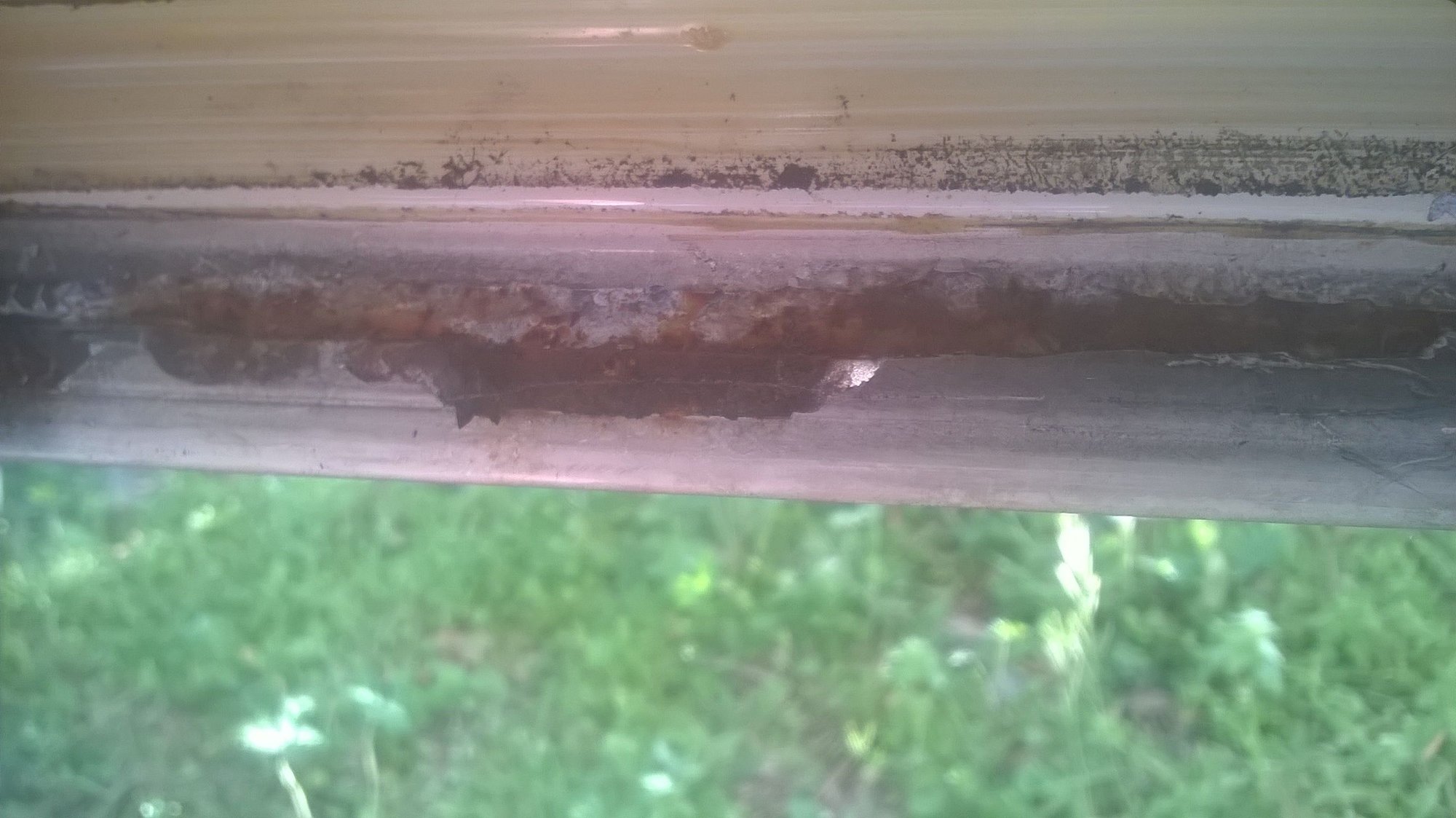

I think I posted some pics of this but since photobucket kidnaped the photos and holding them for ransom, I will post them here.
On my year van and I imagine most vans, they use a seem sealer around all seems and where the metal is bent over, and then they paint it...
I noticed a place under the passenger side front door that looked like there might be a little rust under the paint, perhaps due to the door weatherstrip holding water from the weep holes. I scraped a little bit of the seam sealer off and found surface ruse so I scraped more till I got to good metal.
Next I used a wire brush and some sand paper to get it as clean as I could.
after that used some Ospho rust converter on the area. I had read that it can damage good paint so I mask off the area with tape and applied the Opsho with a rag so it wouldn’t run all over the place, the Ospho is very thin.. I had enough on the rag so that the Ospho could run down in the top edge/lip, of the folded over metal as I applied it.
I read to leave it overnight so I did. Over night I read “not to” leave it overnight, that it needs to be removed before it dries. That article also said you can reactivate it is left overnight by applying another coat, so that is what I did and then rinsed it off while it was still wet.
Next I wire brushed, sanded the area again, wiped it down with denatured alcohol, and primed it. I waited about 15 minutes between coats, 3 of them and then after 30 minutes of the final primer coat, painted it with Rustoleum Semi-gloss enamel.
I should have applied some seam sealer but thought I will see how it goes without it for now. Using the 3 coats of primer sealed the seam up pretty good and then that was followed by the top coat. On top of that, the drivers door had no rust in that area and had no seam sealer in that area.
The water getting in the door is from the old cracked window glass door sweeps which I have the new ones to replace them with.. That will stop the water and so the paint repair will not be exposed to the elements...

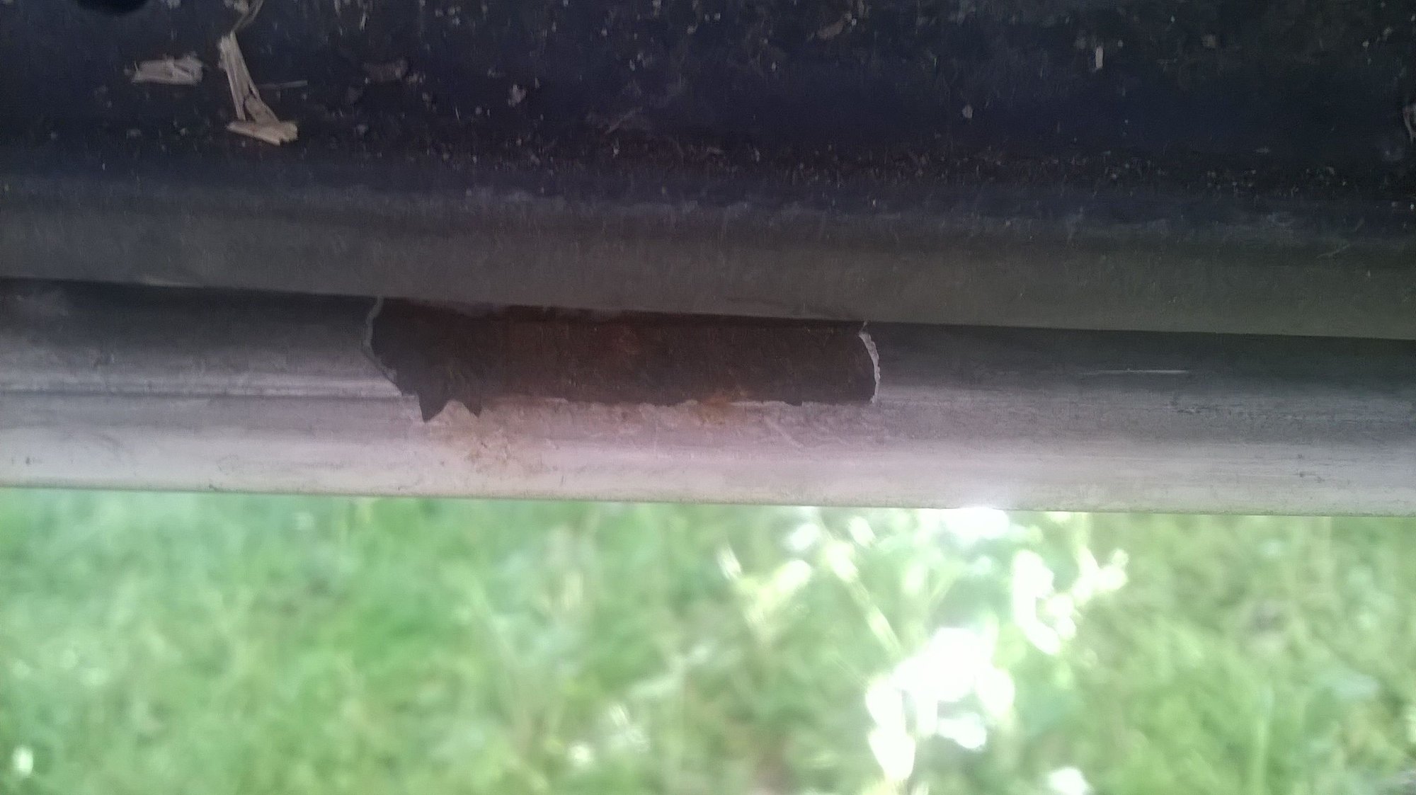

This is the little area under the door after I scraped back a little of the paint/seam sealer
kept scraping

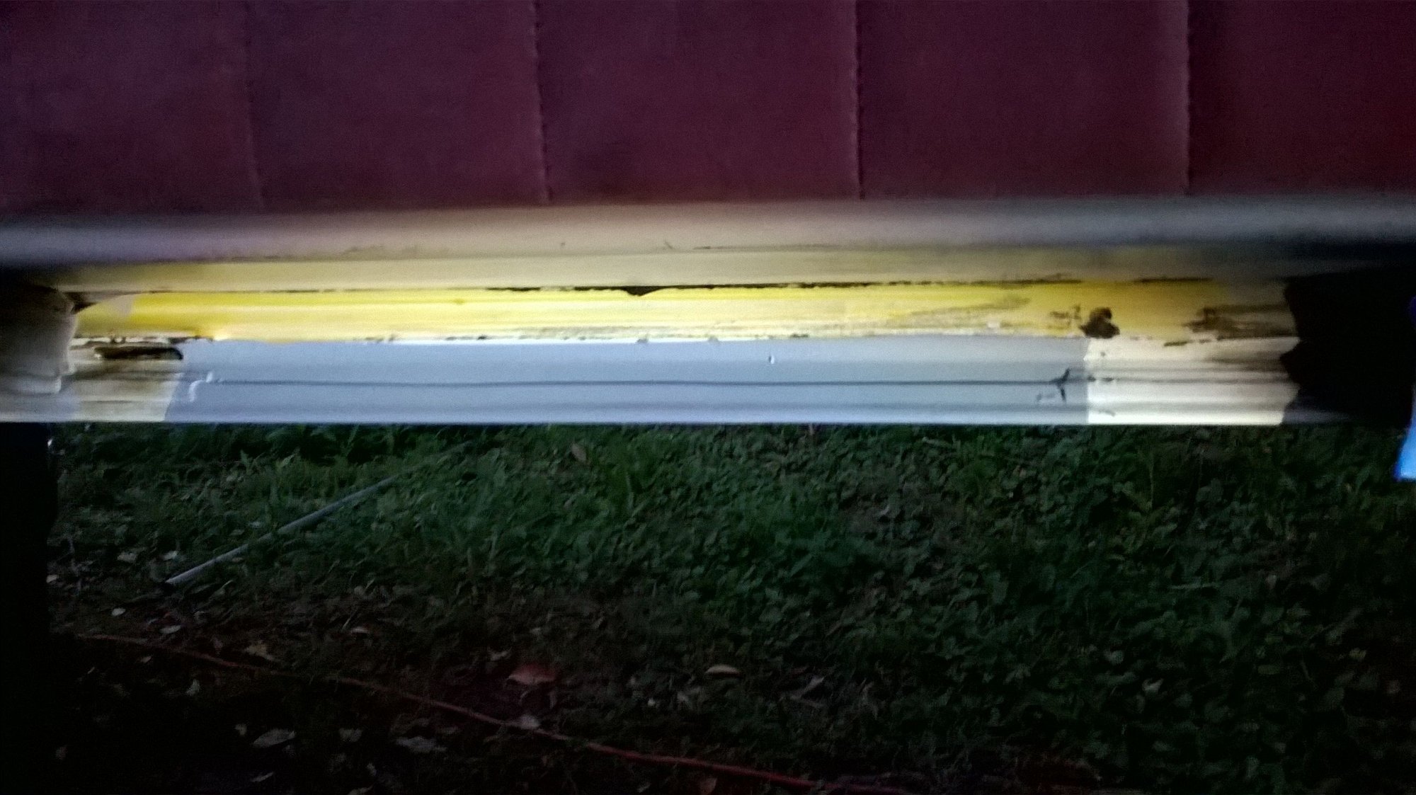

cleaned and primed. any other spots are weatherstrip glue and dirt.
done except for removing the tape at the top.

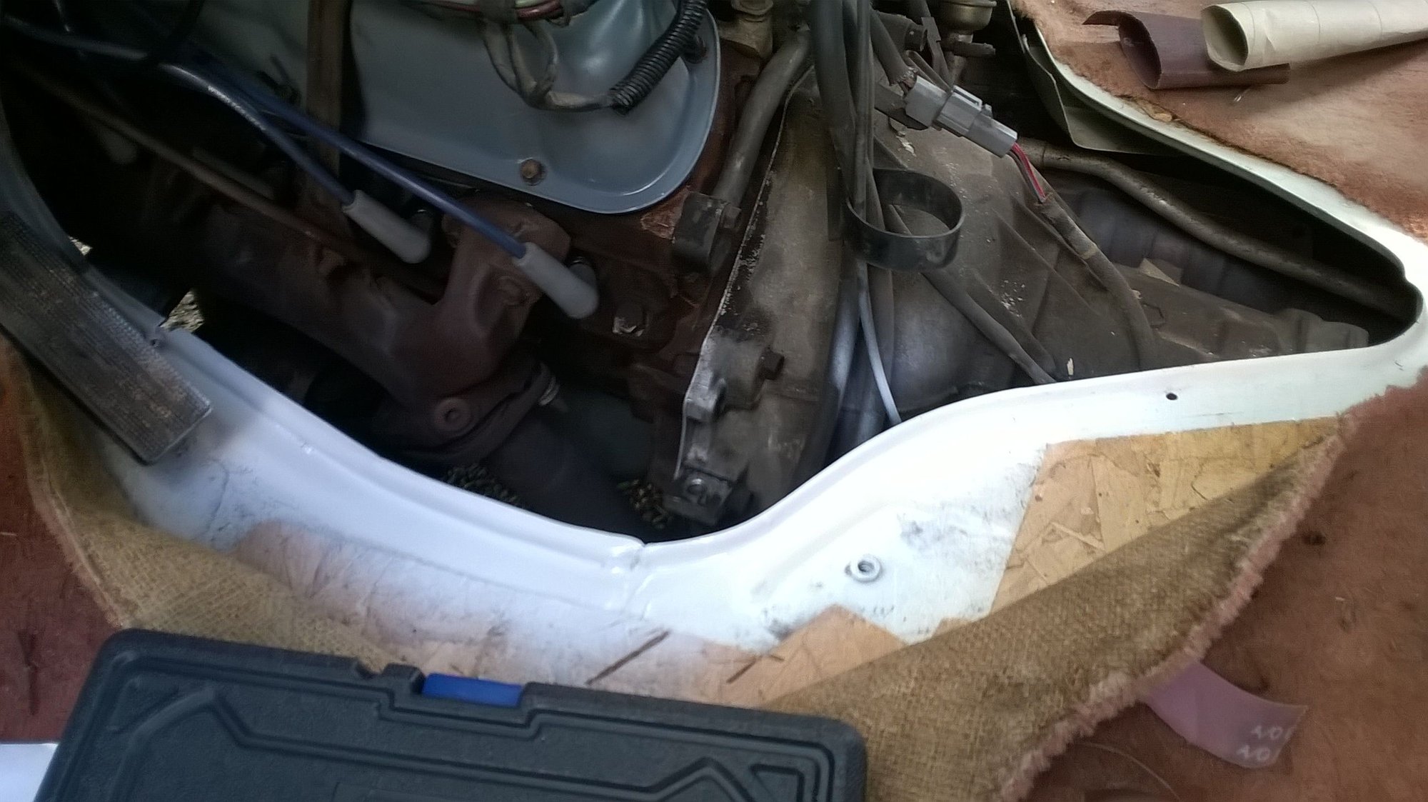

This was a spot around the doghouse. It has been preped like i did the door and ready for primer. I also used a mirror to look underneath the lip and there was no rust.
Primed and ready for paint
Not very professional here as I didn't have tape with me but it is under the carpet and doghouse cover. The point was to stop the rust from growing
