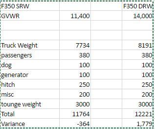

I'm running through the numbers and trying to understand all the factors. I come from the "stay withing the ratings" camp. I think intentionally exceeding the weight ratings on a vehicle is a fools errand.
That said, to pull an average weight 5th wheel (16,000lbs GVWR) the pin weight will be 3200lbs. Obviously numbers will vary. Perhaps the 5th won't be fully loaded to 16k. Maybe there will be 1000lbs light off the GVWR. Guess what, you still have a pin weight of 3000lbs.
Based on the trailer assumptions noted, here are the number comparisons I've come up with between a 350 SRW and DRW
This is using curb weight listings from Ford, which everyone here so far has said are not correct (reality is they are heavier).
My choice is to reduce the payload in the truck, reduce the size of the trailer, or go with the DRW.
Being that you see a 5th in your future, you should take a look at the trailers you'd be interested in and look at their GVWR's. Don't use the dry weights they listed, you need to remember to include all your stuff and fluids.
If anyone sees flaw in my logic, I'm all ears
No flaws in your logic. The math is all there. I see the ratings as a recommendation myself. If I decide to upgrade to a heavy 5th wheel, I will have no problems going to one size larger tire to get 4080 pounds per tire rating and go over the sticker rating on the truck. When companies like Ford, GM, Ram, build these vehicles, the axles and wheels and all the components have ratings with a huge safety factor built in. My dad used to tow a 12000# boat with a 2500# tongue weight with an 89 F250 gasser with the 351 and C6 transmission. The truck handled that boat for years, currently has 400k miles on it, and never had issues. It was way over the weight rating for the rear axles and running gear, but there was never anything to be concerned about.
Run that calculation again with the curb weight of a gas truck and you'll be pretty amazed (I was anyway) how much payload you gain. It was the primary reason we didn't go diesel, other than cost, and want vs. need considerations.
