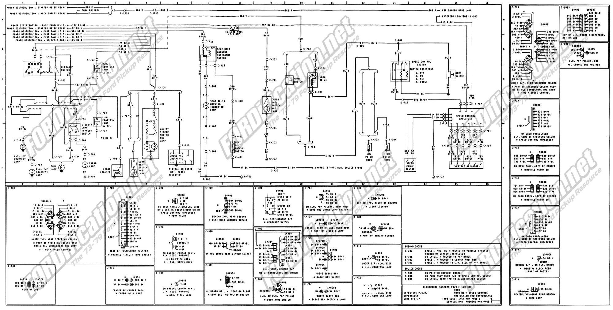

To revive and bump this thread I am going to pardon hijack. I am doing the same thing replace the courtesy light as the contacts were broken off. I installed a new one on the sons F100 and no light. Cause no switches in the jams(guess they removed as they were stuck closed). Found the wire dangling when I installed a new glove box liner tonight, it is hot, as truck was idling. My ?'s will the courtesy light turn on without the switches hooked up or is it om a circuit that requires the switches to be present and functioning, can an anyone post a pic of what the wires look like with connectors for the switches, sons are just cut and taped. Thanks..Mo

Upper pic: Courtesy lamps (if so equipped) // Lower (upper) pic: Dome lamp.
