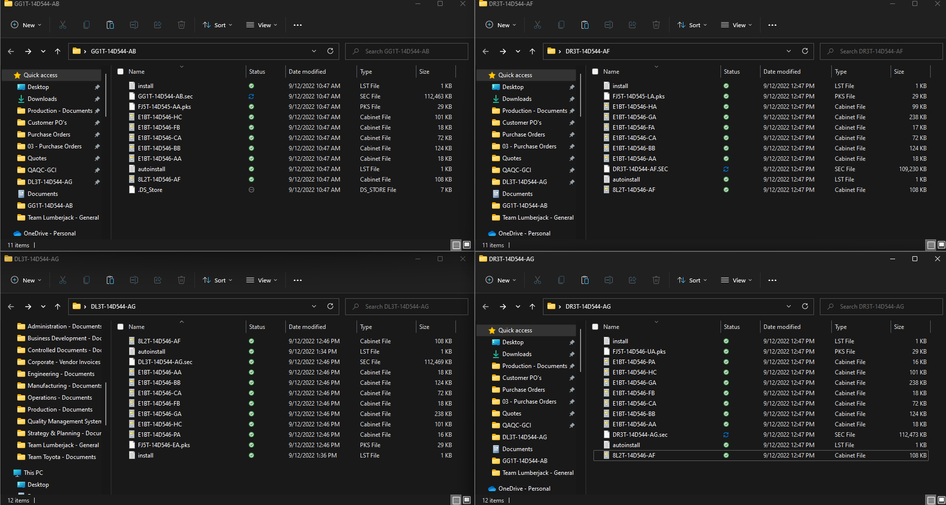

Hello all,
I have a 2010 f150 with Sync 1 (no nav) I updated from sync 4.2 to 4.6 about a year ago with absolutely no issues.
I now have a 2014 mustang with Sync 1 (no nav) and it appears ford no longer provides the updates on the syncmyride website. I called Ford and they said they dropped the North America support for Sync 1 and you need to go to a dealer to update.
I now have 4 versions i found online (Screenshot Below of these packages)
DR3T-14D544-AG - Found on a forum
DR3T-14D544-AF - Found on a forum
GG1T-14D544-AB - Found on a forum
DL3T-14D544-AG - Downloaded from Ford UK Website using my 2014 mustang VIN
I have tried loading these all to my car over 20 times already.
I have 2 usb sticks, both black tab USB 2.0. One is 16gb and one is 8gb.
I have doublechecked the naming in the files and deleted the "SyncMyRide" Folder and renamed lines in the "install" and "autoinstall" as directed above. Nothing seems to work. any suggestions?

I know it’s been a while but if you’re still having problems updating it might be because of your current sync system. Sync 1 only updates to #2, and #2 to #3. You wouldn’t be able to jump straight from 1 to 3 when updating because the updates install into the previous version.
Try updating to the second version first then to the third.
Also is there any chance that you still have any of the sync 3 files cause I’m trying to update my 2011 stang too
