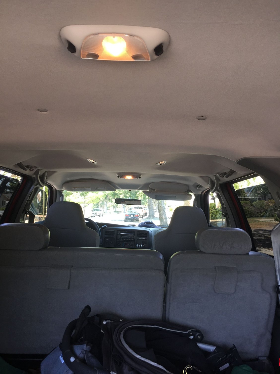

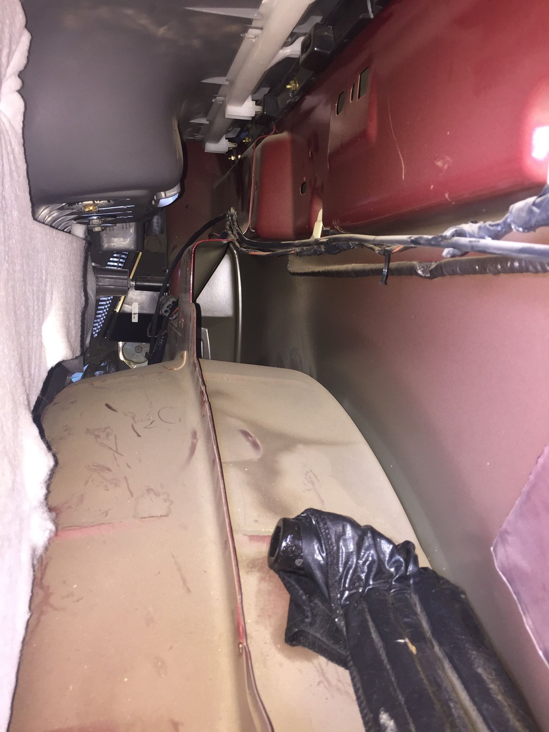

Here is what it looks like in the jack compartment. It was a custom ordered by the fire department for use in a wilderness area. It was the fire chiefs vehicle so there were a few strange mods like no rear seat and some interesting electrical work and several holes in the roof from various antennas. Again, don't really know what I am looking at here. I see a speaker and some unused wiring harness. Any of this look like AC stuff? I got a good deal on it and so far the ac is my only complaint.

You probably have an "XL" in it's previous life it was most likely a government vehicle. Edit: I read your second post "Fire Dept"
Do you have carpeting or rubber/vinyl flooring?

Wow, the headliner doesn't even have vents for the AC...

Yes. I have vinyl flooring.
