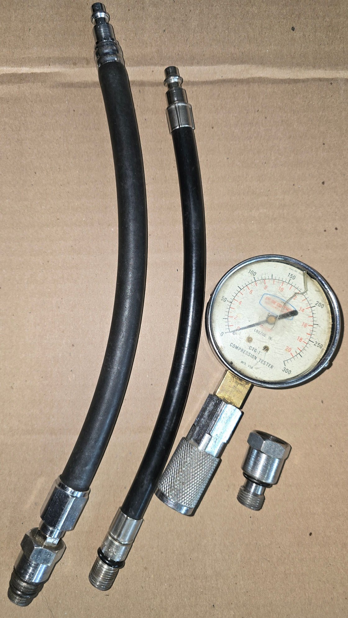

120-140 psi is the spec for your 5.4
To pass the test, the lowest cylinder should be within 75 percent of the highest
Old Dec 15, 2024 | 04:42 PM
manicmechanic007's Avatar
manicmechanic007
Joined: Jul 2020
Posts: 10,522
Likes: 2,654
From: Near Salt Lake City
I've been using this Proto since about 1980 I bought it used for 20 bucks
Cracked the plastic a few years back
I had to buy another adapter hose to do the longer reach ones like the 4.6 and your 5.4
They take special Schrader valves you get off a tool truck
