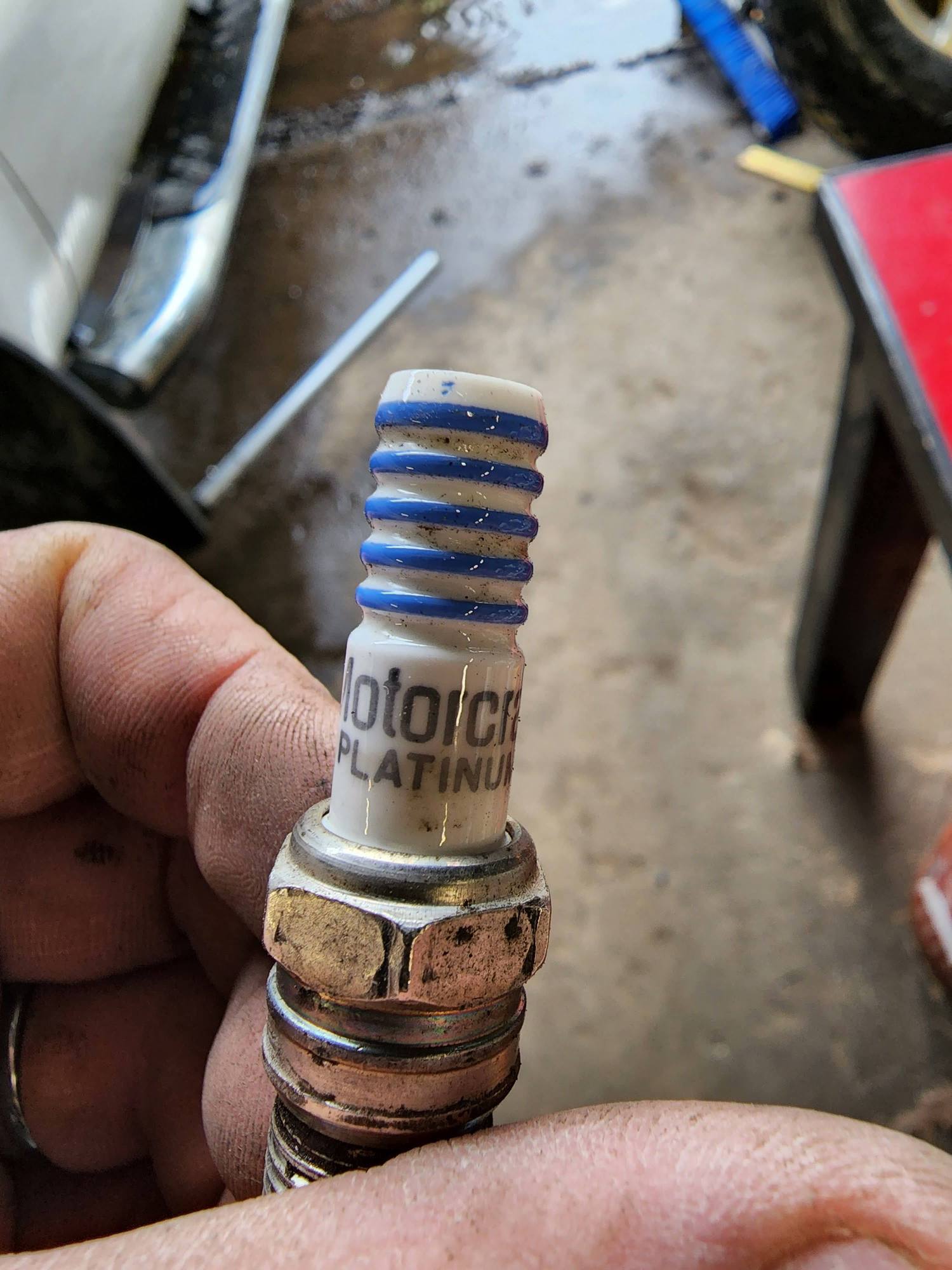

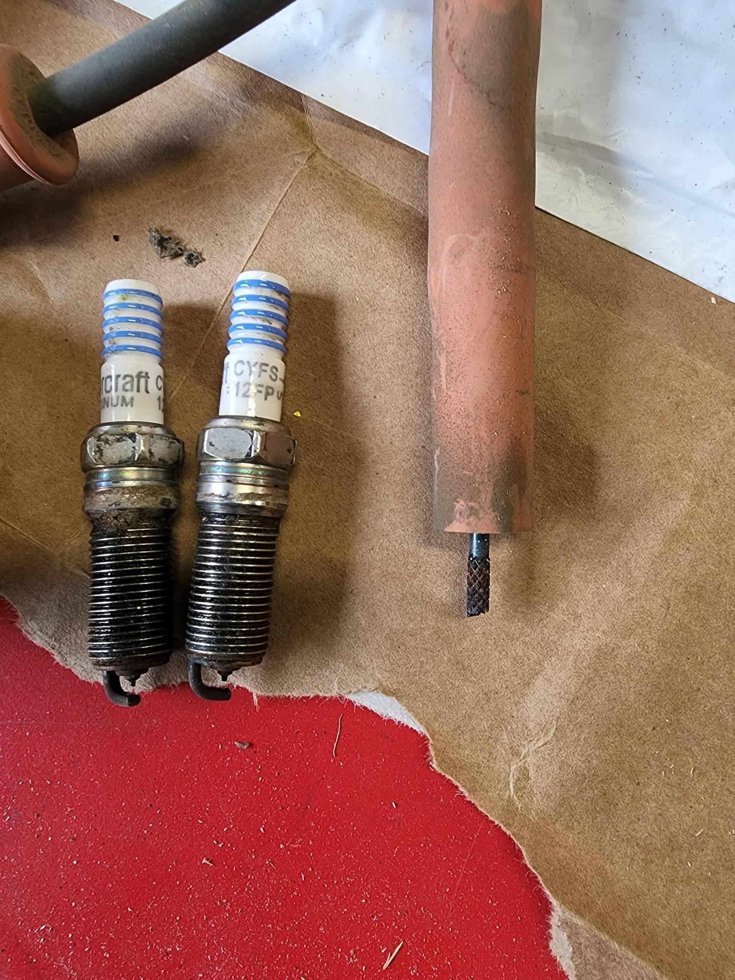

So about about 2 months ago I had a weird issue that kind of felt like a shifting issue while hauling an empty dump trailer down the freeway, Turns out it was my Cyl-1 spark plug wire was not solidly on the plug...
After talking to some buddies I decided to buy all new motocraft plug wires, I had replaced the wires with denso's back in 2017 when this was posted... Well.... I just found some wierd issues.. I went and pulled the plugs on the drivers side, and the first cyclindar and last cylendar were missing their electrodes!
Needless to say I will be replacing the plugs today and then adding the new motocraft wires.
