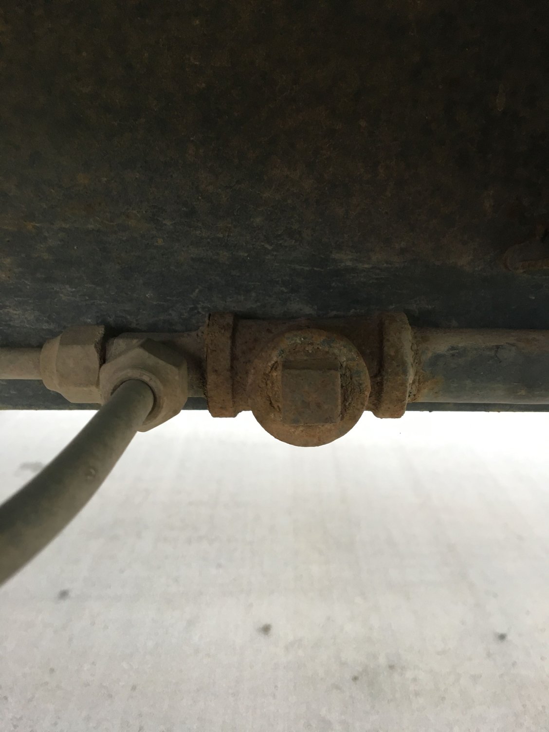

i have a 2007 Weekend Warrior LE3505 and found this T fitting with a plug along the propane line leading away from the bottles up front.
Looks like I need a male fitting that screws in at this T once I take the plug off. Then I was hoping I could find the right fittings to adapt to make a quick connect for an external grill. I'd like to run the grill off the RVs propane instead of the crappy green bottles.
Any ideas??
heres what I was talking about.

That appears to be plain old pipe with plain old pipe threads. You will need something that adapts the line to your outside grill to pipe threads, and probably some additional plumbing there to make it more accessible without making it vulnerable to damage.
