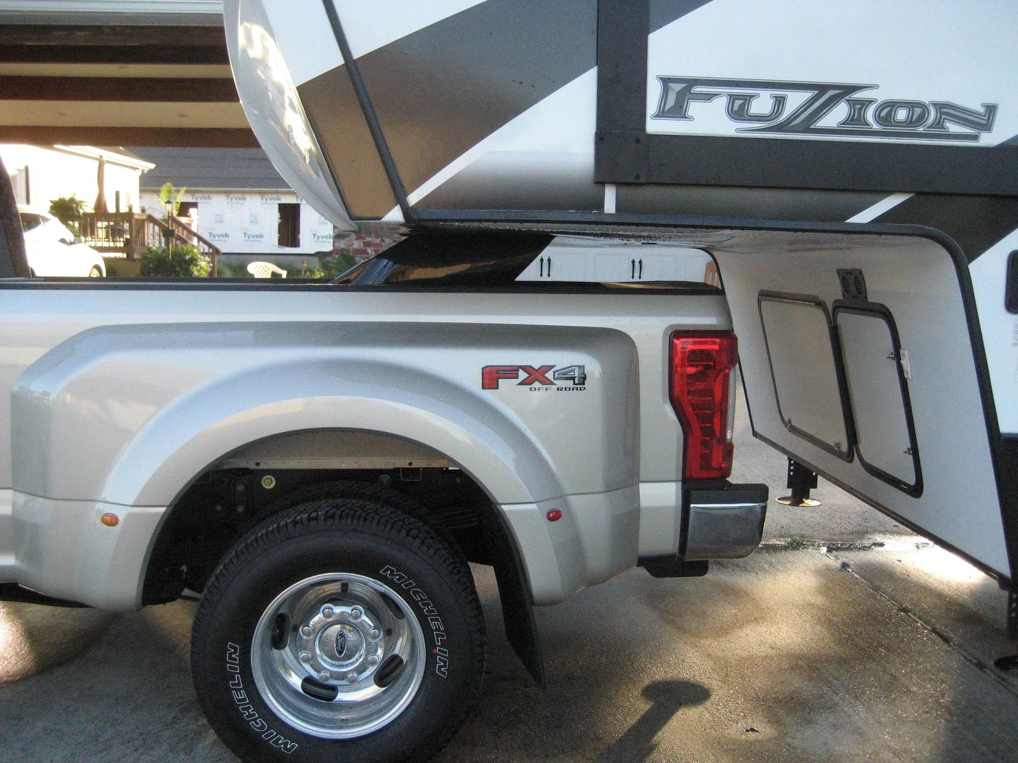

The DRW is the same 176" WB as the SRW with the 8' bed. Love the 48 gallon fuel tank on the long wheelbase trucks. The rear duals don't stick out any further then mirrors so just watch what you're doing when you park. Much more stable when towing also and with the 4.10's pulls like a train. Use mine for a daily driver and go to the post office..bank..grocery and everywhere else! A lot better then using son in laws F-250 short bed that was over on payload with the heavy pin weight on our trailer. Wish I would have bought a dually sooner.

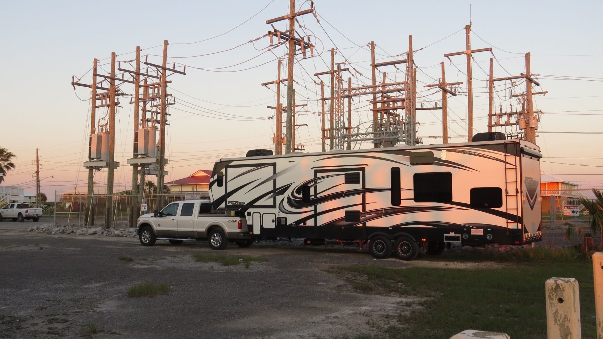

Most fifth wheels, loaded, put 23 - 24% of their gross weight on the pin (toy haulers tend to be a little more back-heavy). Our 14K fifth wheel weighs in at 3,100 lbs on the pin. A 15K trailer loaded could be between 3,400 and 3,750 lbs. on the pin. The mistake many people make when considering trucks to pull a larger fifth wheel is to focus on the engine and drive trail. Sure, diesel is very important (I wouldn't tow without one), but rear axle capacity is critical. With 15K GVWR fifth wheel, you're in F350 DRW territory. Having "been there, done that," I'd rather tow with a V-10 gasser and dual rear wheels than a 3/4 ton diesel that doesn't have enough payload capacity.
