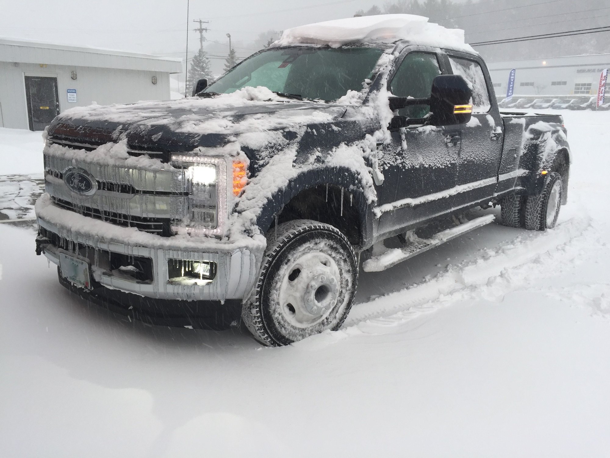

I like the Firestone Winterforce with studs. They're a bit easier on the wallet than the Blizzaks, Nokians, and Hakkapeliittas.
I moved down to a somewhat narrower 17" inch tire that can bite through deep snow a little better than the wider 18" or 20" models.
