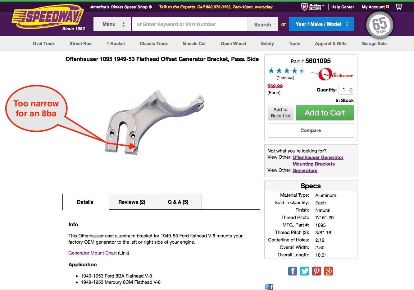

Originally Posted by petemcl
Monday I should get the offset alternator bracket from Speedway.
Well the offset bracket from Speedway came but it doesn't fit despite the fact that their website says it does. The first problem is that it puts the generator/alternator right in the middle of the right radiator tube. Offenhauser says that they make a replacement thermostat housing and special tube that routes the hose to the right of the alternator/generator (kind of odd looking in my opinion). But they also said that that bracket's mounting throat is too narrow and allows the bracket to twist sideways in the mount on the intake manifold.
So it is on to plan C. I already have a steel GM 1-wire alternator bracket that works well. I just need to extend the base about 4-6" to raise the alternator to clear the Unisteer pump and brackets.
Here is the Unisteer pump all mounted with the correct hoses and belt on the forward pulley.
