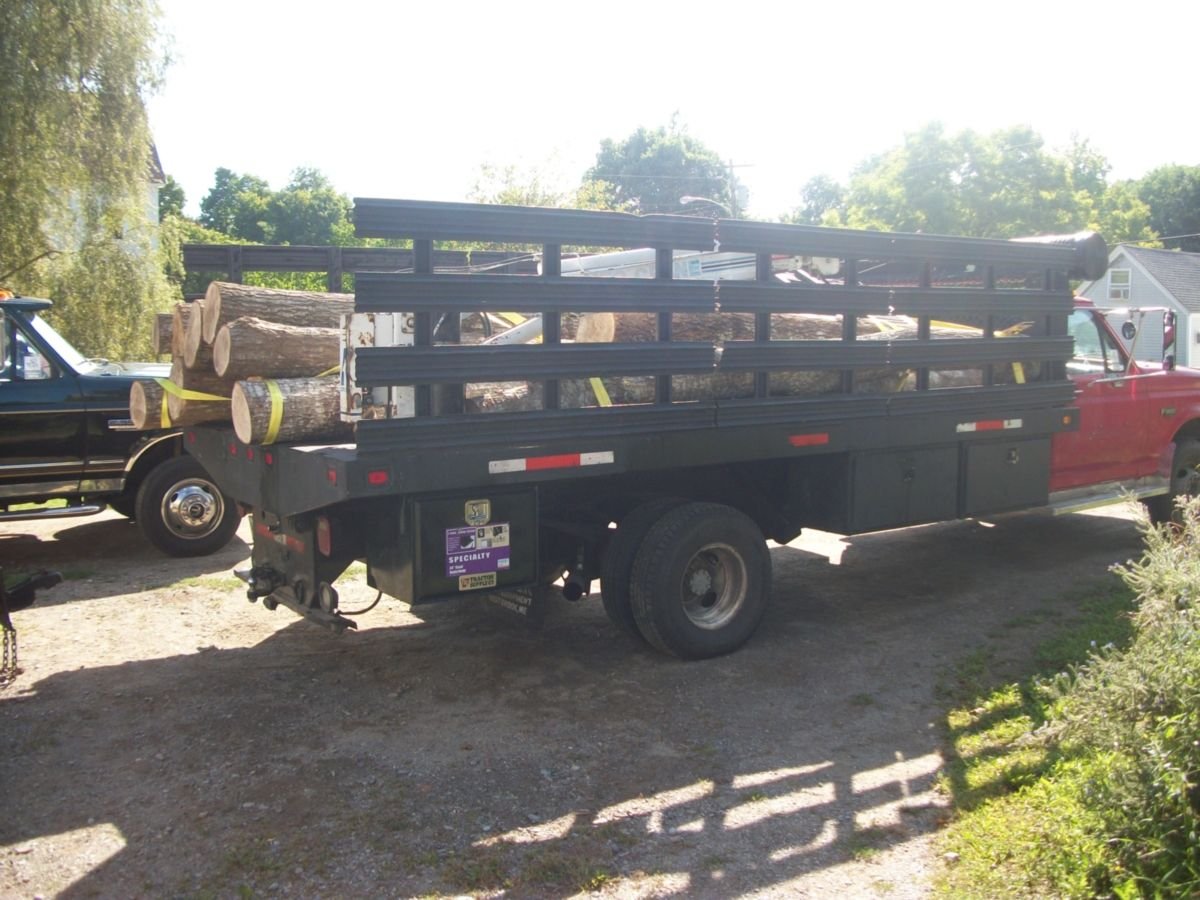

Source yourself an 87-97 F-Super Duty (F450). That will handle what you want to do with it.
The F-Super Duty 1987-97 (the original super duty prior to '99 pickups) was Fords introduction of the class 4 medium duty truck. It was a commercial cab & chassis 2WD dually only optioned truck.They came with 460 gas engines all through the production run, with the optional 7.3l idi diesel engine from introduction through '94,then the optional 7.3l di (power stroke) diesel from '94.5 - '97.
Known at the time as the "One Ton Plus." It sports a HD frame,the hydroboost brake system w/ 4 wheel disc brakes.Though they are 2WD trucks,they are equipped with 4WD transmissions but,rather than a transfer case,they come with a drive line parking brake. A HD dana 80 rear axle that came from ford with gear ratio options intended for two purposes; heavy hauling & towing.They came in various wheelbase lengths with up to a 15,000 LB GVWR.It's widely known as the F-450 equivalent with many auto stores listing parts under either name.
These trucks are easy to spot with their pickup size cabs,yet unique F-Super Duty fender emblems & 10 lug wheels.
axle code 72 = 4.63
axle code 73 = 5.13 (most common and what log truck has)
axle code G3 = 4.30LS (rare)
Here is mine with a custom stretch.
