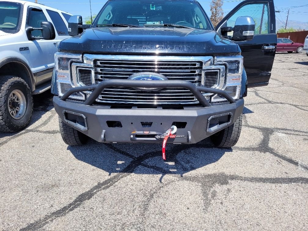

It depends on what you are after: looks to serviceability. In my hard core days, I liked the armoured front end. But after driving the Dodge below with a mezzo-mezzo beefed up winch carrier for 20 years and only using it to pull other people out of a jam, I'm going for the sleek-sleeper look. It is still as capable as the aftermarket bumper/winch combos. It's all a compromise.
The main thing is the OP wants a hidden winch.
This winch carrier is a Warn product with a 15K Warn winch. After hitting a bull elk at night coming across hwy 50 through Nevada, I added schedule 40 tubing and a radiator saver to beef it up.
The winch and carrier are pretty heavy. The winch, carrier, and bumper add ons are easily 250 pounds of dead weight sitting on your front end.

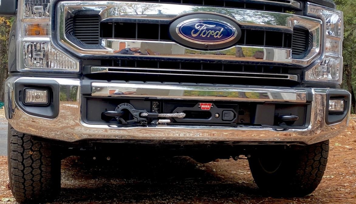

A wider photo of the Ford-Warn hidden winch mount with peripherals:
Without the blue flag, you'd be hard pressed to know there is a well designed winch behind the stock bumper.
I think the people who wanted a hidden winch have taken care of business or moved on to other pressing issues.
