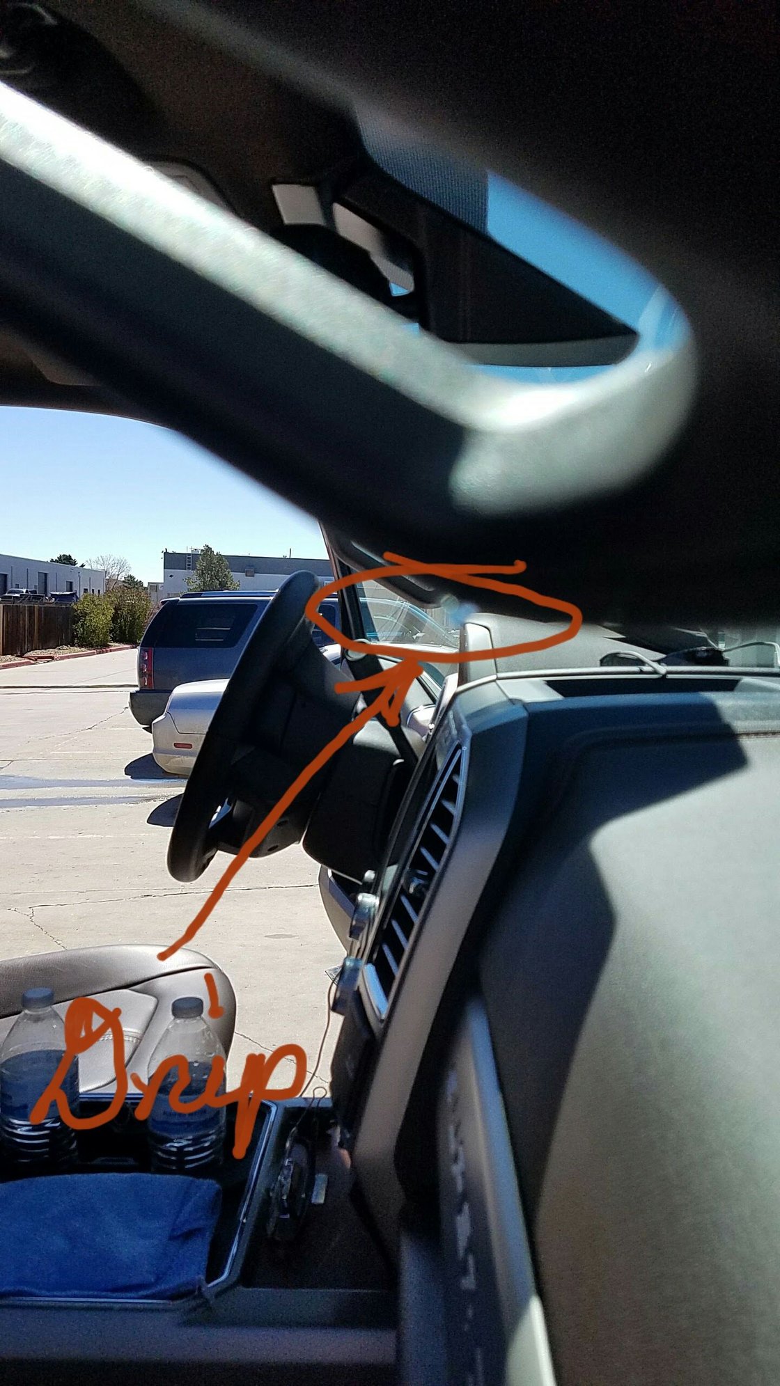

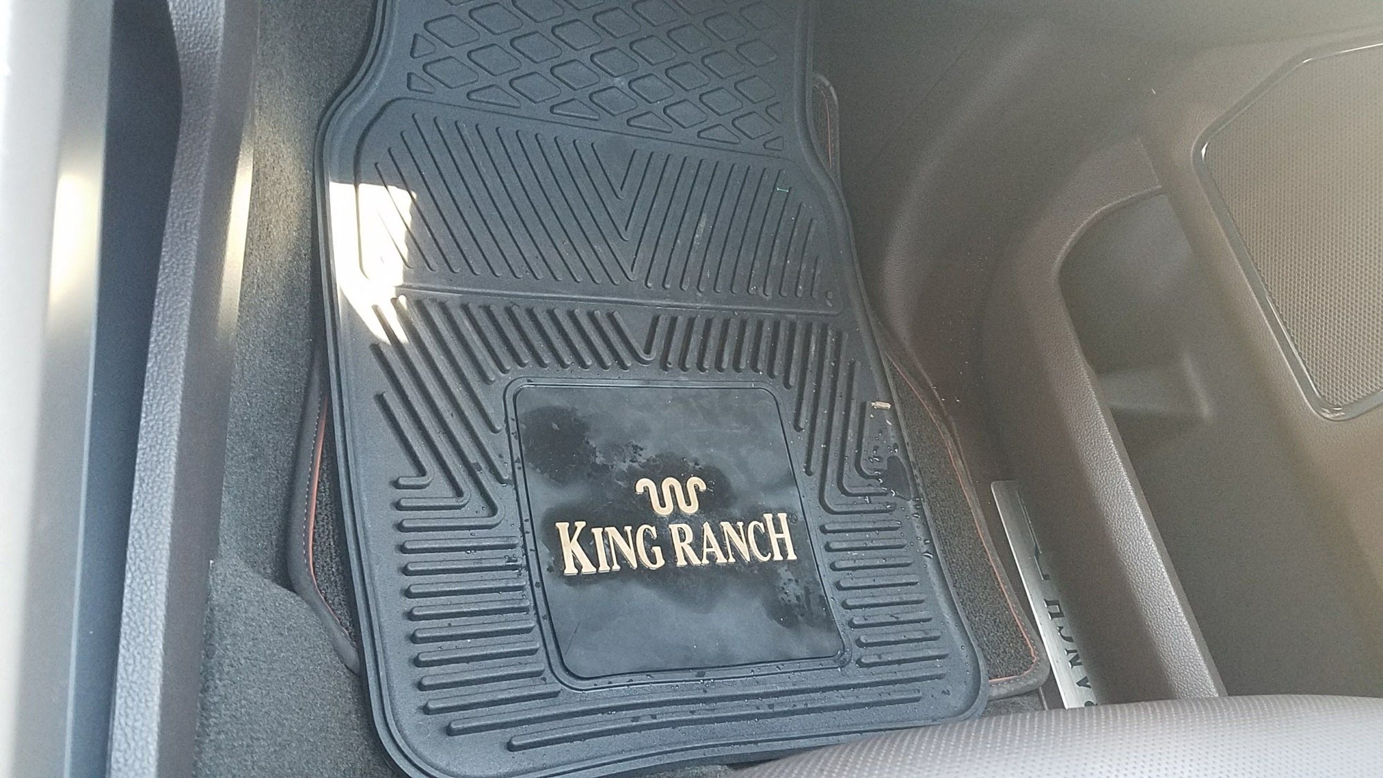

Back story....driving to Denver thru Eastern Colorado on two lane in a mid April rain/snow/heavy wet slush. ...heavy snow fall! The slush on the highway is probably 2" deep and light traffic. ...then I meet an 18 wheeler and take a load of slush on the windshield. I couldn't believe how loud it was in the cab and still had a winshield in place. Fast forward, make it to Denver and the next morning I find this in the truck. ..
Difficult to see droplet but had to dry it several times.
Since then, I've been in heavy rains parked, driving and truck wash with no leaks or water. Maybe this will help someone make the case with a dealer as to an issue but for me, so far, hasn't happened again.
My sons 2016 F150 has the exact same issue. He videoed it leaking and his console looks just like yours. He's had it into the dealership twice now and they're telling him that this is normal for this body style. He's not happy having a $50,000 terrarium. Mold is starting now.
I guess since it has an aluminum body and rust isn't an issue,,, Ford figures, let it leak!
