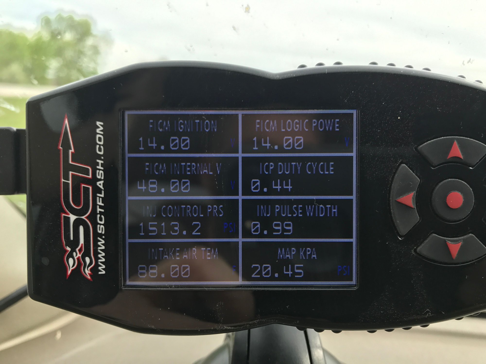

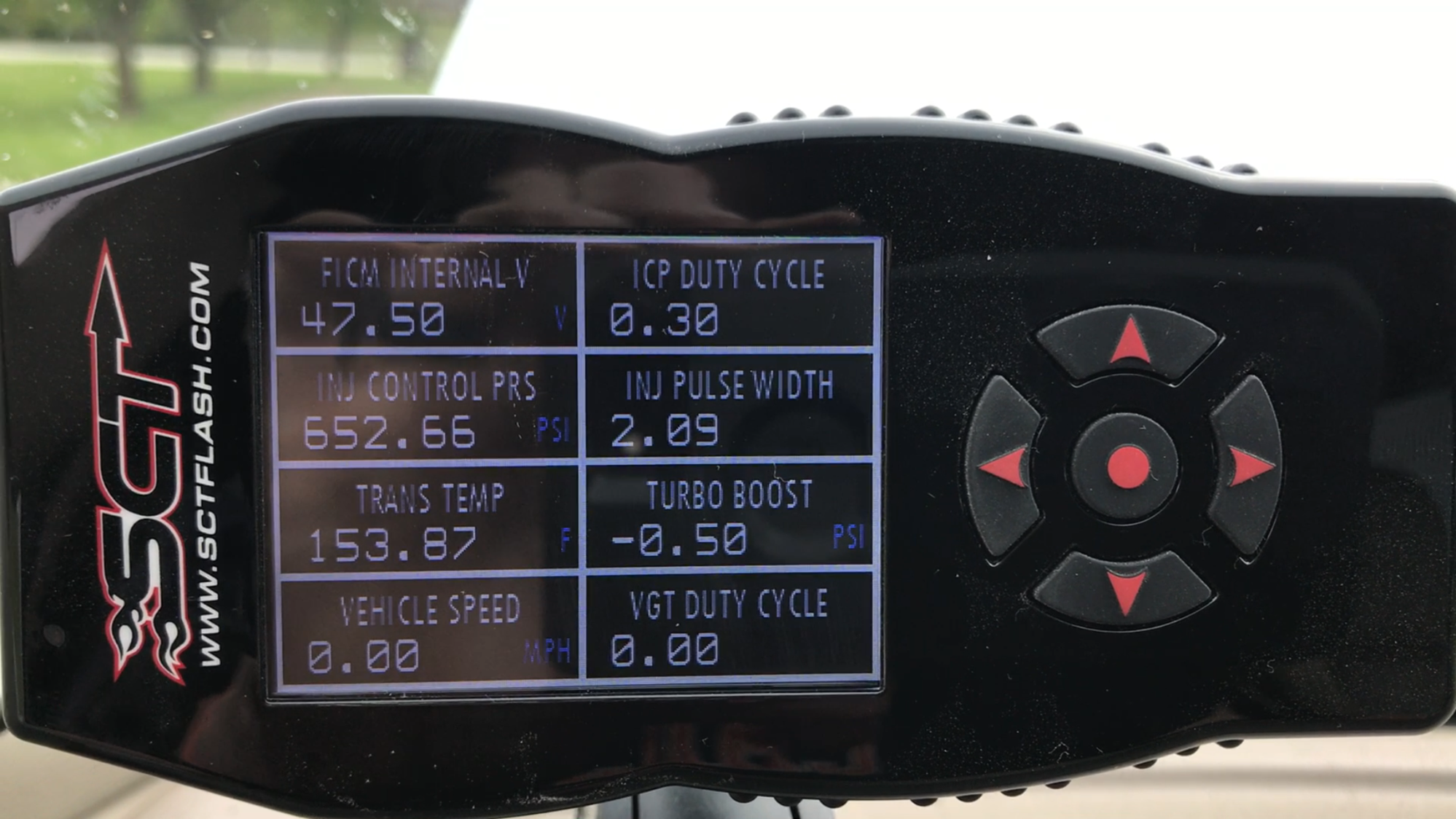

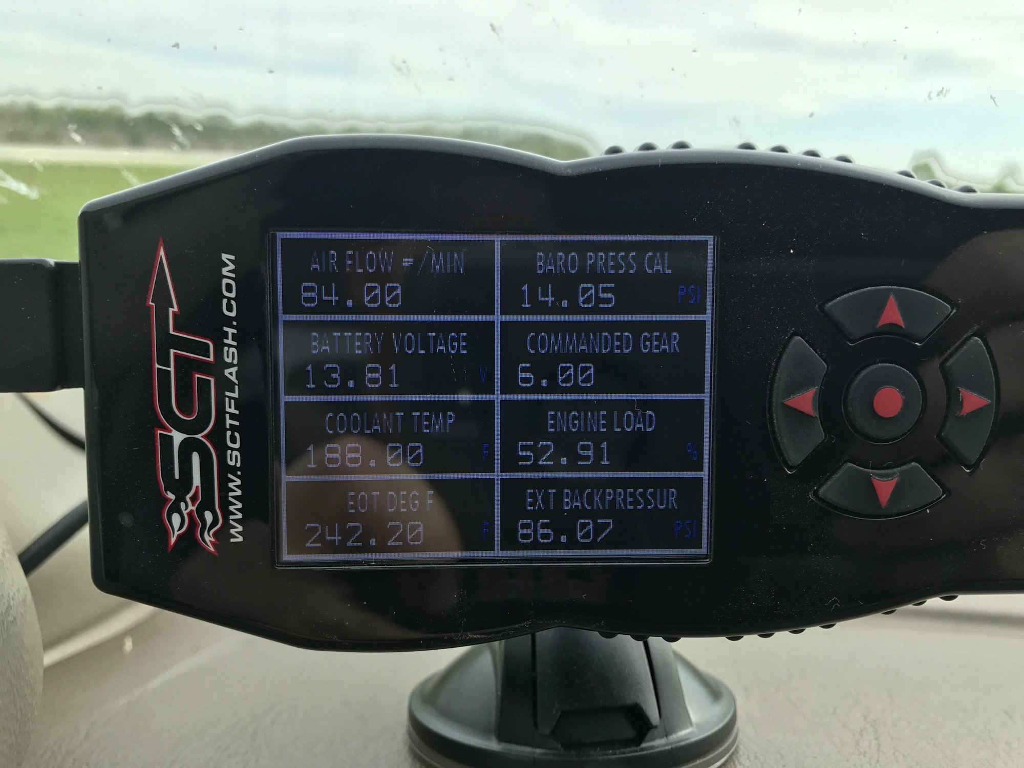

Ok so I flashed my truck back to stock just to start diagnosing with baseline stock numbers. My first 3 pics are me doing 75 mph on the interstate after nice and warmed up. The fourth one is a no start condition with the ICP pigtail plugged in. The 5th is when it started with the ICP pigtail unplugged. I noticed after flashing the truck back to stock my EOT went even higher. Nothing else seemed to change except the turbo flutter is a little less noticeable. I assume that's because the performance tune makes more boost which will create more flutter. Let me know what you guys think.

The good news is you are not puking coolant but are way overdue for an oil cooler, first thing I would check is that the EOT and ECT are the same or close after sitting overnight, that would rule out a bad sensor.
As for the no hot starts, and this is assuming it starts good cold just not hot? It is time for an air test. You have an 04 with the ICP on passenger valve cover, so it could be the dummy plugs and/or stand pipes.....many will do them both at the same time and they come in the same kit.
It could also be your HPOP, since you have a mid change engine......it's going to have the early build HPOP which is another know failure point.
Looking at those figures, I would not be driving it with EOT that high if that is accurate.
As for the no start, looks like you have a leaker.
I also wonder is that EBP a little high?

So you have a HPO leak on top of your oil cooler issue.
Is the ICP on the PS valve cover or tucked in under the turbo?
ICP duty cycle shouldn't ever be 84% its trying to compensate for a leak to build the ICP pressure to start.....just went thru this issue with my own truck.
