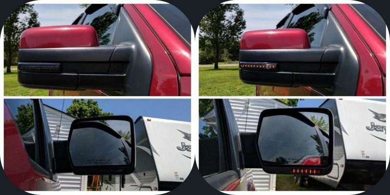

I just installed the kit...except for the trepidation/slight difficulty getting the glass off the mirror motor (was being very careful since I didn't want to break anything!), the install of this kit is VERY simple, and it's totally plug and play. The reflector is replaced with a blacked out LED strip which is wired to a two-pin molex, and the turn signals (inside of the mirror) are replaced with smoked units which feature two pins for the outside LED lens to plug into.
I don't have puddle lamps, so I can't speak to their install/effectiveness. The factory turn signal location seems like it might be a tad brighter, but when off, the smoked lens blends into the mirror housing very well. And the front reflector replacement looks great: glossy black finish, and the LEDs seem pretty bright as well.
While I had it all apart, I decided to fix the omission of chrome mirror caps on the XLT Chrome Package, so now my mirrors are chrome-topped, with signals on both sides of the mirror head, and no gaudy orange reflector marring the appearance!
I'll get some pics tomorrow and see if I can edit them into this post.

Yea, I think the factory turn signal at the back of the mirror is a tad brighter, but I also thinking it's because it's a clear lens with amber backing and also because the smoked ones are deflected away from the interior so they're not quite so bright. Install is super easy besides getting the mirror glass off, agreed! I really like how they integrated the outside turn signals with the inside ones using the molex connectors. Very cool idea! Those orange reflectors are definitely terrible!

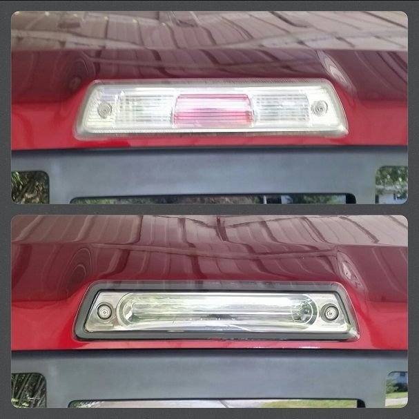

This is the smoked 3rd Brake-Light I bought a year ago, still works/looks perfect
09-14 Ford F150 Smoke Tint Full LED Rear 3rd Third Brake Tail Light Lamp | eBay
Pic order...OEM, Smoke, Cargo Light On, Brake Light On

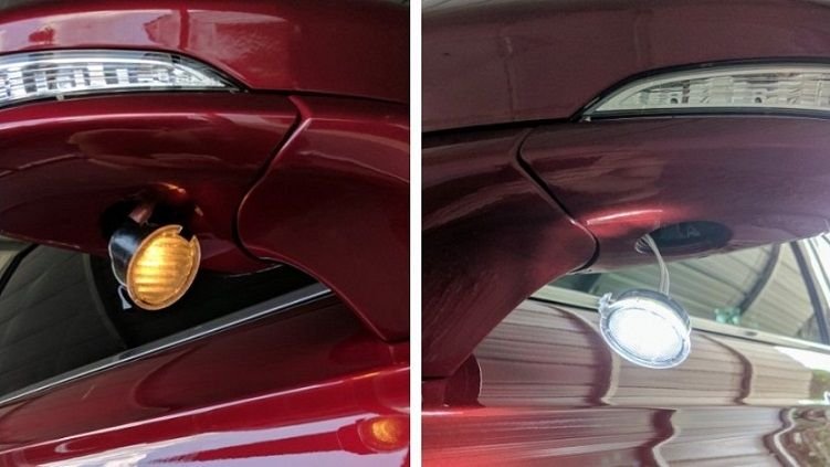

Purchased the "PulleyAutoParts" Kit myself, but ended up installing the included Puddle-Lamps in my wife's 2016 Fusion as an upgrade.
I didn't feel like hard wiring those in my Truck & since her car comes with stupid halogen bulbs in the puddle lamps (LED's everywhere else, thanks for slacking Ford) I gave her car a present too.... Bought off eBay
