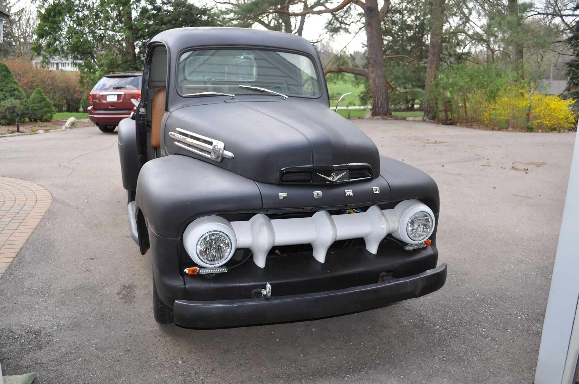

Yes, Ross is correct. Here is my 1950 F2 with 1952 front end.
