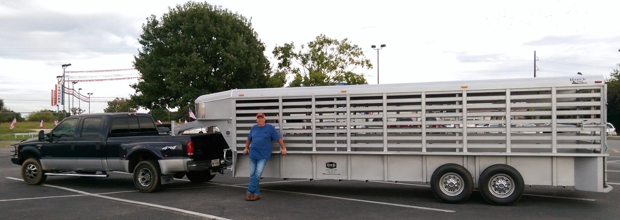

I've searched for a thread with the same problem I'm having and came up empty.
I recently purchased a new livestock trailer that is equipped with LED lights. The lights work as designed and the turn signals flash at the slow steady pace of the truck. Here's the oddity: when the truck is turned off with the key removed, the brake lights will briefly flash about every 8-10 seconds.
All of the threads I found discuss hyper-flashing of the turn signals but that's not what I'm experiencing. Any suggestions on how to cure this problem?
Thanks,
Don Z.

Great information in the replies! To recap the questions posed:
Truck is a 2000 XLT, 7.3
No security system
Aftermarket brake controller, Prodigy II - From their product description: "Continual diagnostics check for proper connection, shorted magnet conditions and much more." The unit has LEDs that show connection while the truck is running. They will stay lit for about 10 minutes after the truck is shut down, then they turn off. I assume at that point the unit is longer drawing power from the truck battery since it could kill the battery if the truck sits for an extended time.
The truck is equipped with ABS.
The trailer is equipped with a break-away switch and battery.
Thanks to all for your assistance!
Don Z.
